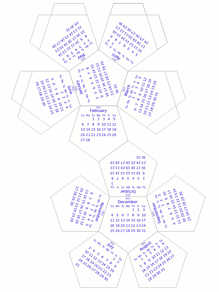

Inspired by the images on this website (I don't speak Spanish), I started working on a script which, in conjunction with the Calendar script, will render a calendar shaped such that it can be folded into a dodecahedron. The script is in its seminal stages, but if anyone is interested in trying it in its current form, it can be downloaded from this page. EDIT: please visit this page for info and links on the latest version
I will eventually get around to fixing up the layout and adding the ability to map images onto the sides (the "facet image" option does nothing right now), but if anyone wants to experiment with this preliminary version, it is somewhat functional.
The command is called "Platonic calendar" (a dodecahedron is a 12-sided platonic solid) and is found under "File->Create". The default edge-length of "450" should produce an image suitable for printing on a DIN A4 sheet of paper at 300DPI (though this may need some tweaking).
Here is an example output using an edge-length of "150":

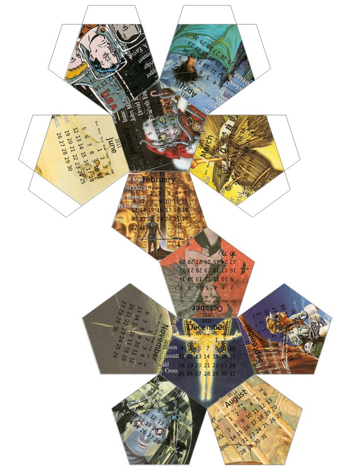

I hadn't gotten around to implementing the facet image with that first version. I did some coding last night and I think I've got it working (it wasn't as difficult as I thought it would be).
The new version can be obtained by following the link on my Chiselapp webpage.
Here is an example using magazine covers from Fantasy & Science Fiction for the facet image:

Your images in the calendar are cool. How did you get different images in the calendar? More experimenting. :mrgreen:

I've just updated my wiki page. Here is what I wrote:
The facet image can be a single layer or multiple layers. If the facet image has twelve layers then each layer will appear on a different face of the dodecahedron (bottom layer is January, top layer is December). Fewer than twelve layers will result in the layers being repeated to produce the twelve faces (e.g., four layers would be "cycled through" three times).
The facet layers will be centered and scaled (up or down) to completely fill the facet. (I made it so that if a facet layer is linked then the layer will not be scaled but this feature may prove difficult to use.)
Here is an example output using an edge-length of "120" and various covers from Fantasy & Science Fiction magazines as the facet image (you can use "File->Open As Layers" to create a multilayer facet image).
