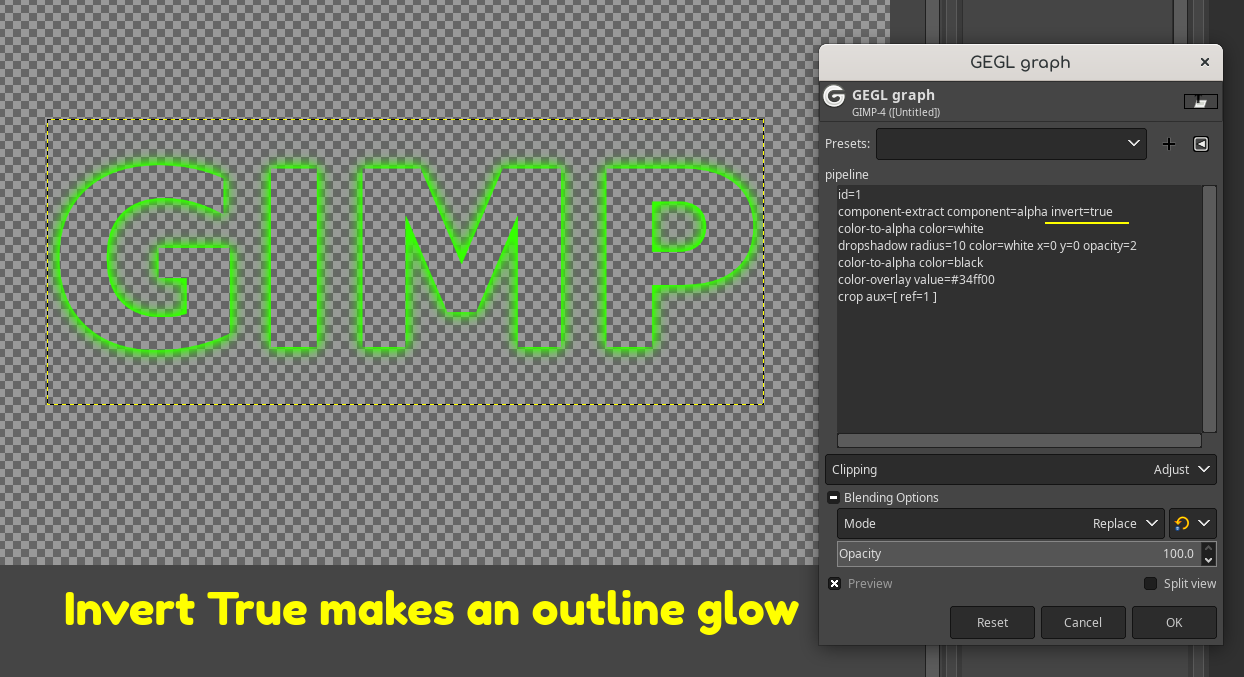

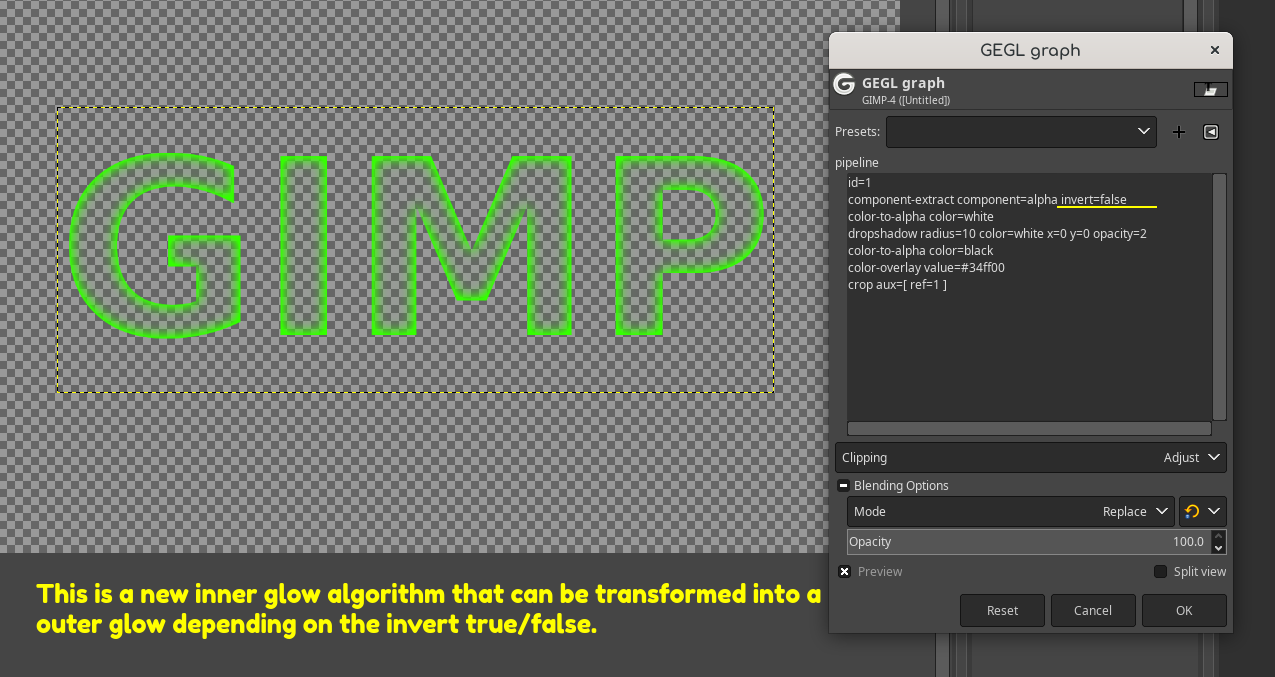

I am thinking of making a plugin that does outer glow to inner glow transitions depending on rather a invert checkbox is pressed. The GEGL syntax used to create it is here
id=1
component-extract component=alpha invert=true
color-to-alpha color=white
dropshadow radius=10 color=white x=0 y=0 opacity=2
color-to-alpha color=black
color-overlay value=#34ff00
crop aux=[ ref=1 ]
Invert set to false (inner glow)
Invert set to true (outline, shadow glow)
Plugin is expected to be used with GIMP blend modes (Blending Options). Try pasting the syntax in GEGL graph and changing the invert checkbox and dropshadow values to see how it functions.

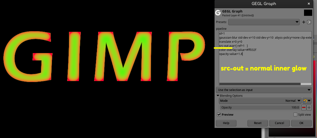

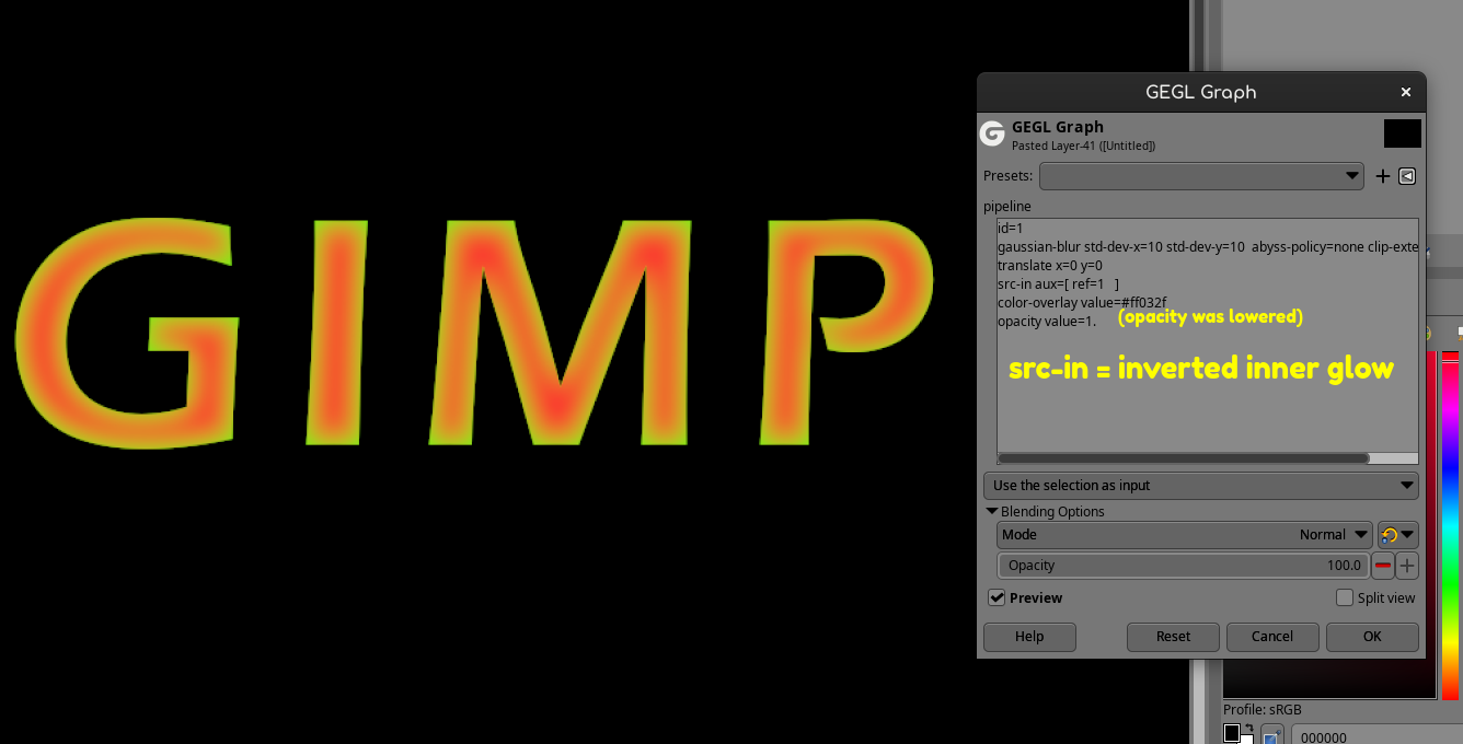

src-out/src-in are GEGL exclusive blend modes that erase content outside a input mask which in this case is the text. So imagine a text mask knocking out the red gaussian blur puff outside. Src-out does exactly that, and src-in does that but with inverted transparency. ref=1 is the bookmark of the original text being called
Inner Glow
id=1
gaussian-blur std-dev-x=10 std-dev-y=10 abyss-policy=none clip-extent=false
translate x=0 y=0
src-out aux=[ ref=1   ]
color-overlay value=#ff032f
opacity value=1.3
Inverted Inner Glow
id=1
translate x=0 y=0
src-in aux=[ ref=1   ]
opacity value=1.3
I am discussing technical ways to revamp and perfect my existing plugins and others have yet to begin making a GEGL plugin

My Inner Glow plugin that ships with GEGL Effects now uses
id=1
translate x=0 y=0
opacity value=1.3
In revised mode. Its exactly the same as default inner glow but without gegl:crop and the bug that comes with gegl:crop
