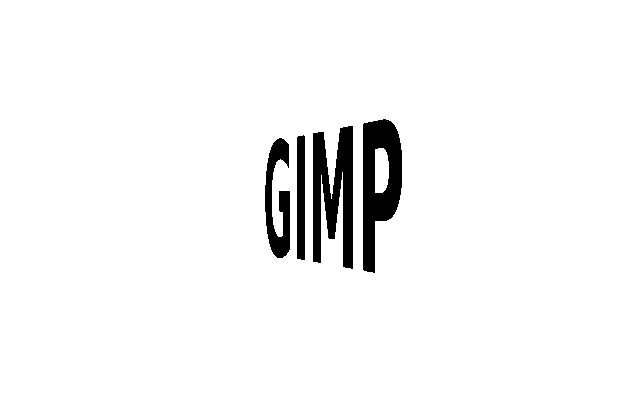

here's a simple script to assist in the animation.
It'll be available under Script-Fu/Create New/Rotate Plane Animation...
It'll create new layers to rotate all your visible frames, it'll delete original frames then you can save as .gif animation.
Rotate_Plane_Animation.scm [4.6 KiB]
Downloaded 350 times
you can select number of frames per (visibled layer) and rotation type (Horizontal/Vertical/Both) selecting "Both" will make it look like a diagonal rotation
Here's a sample run result
