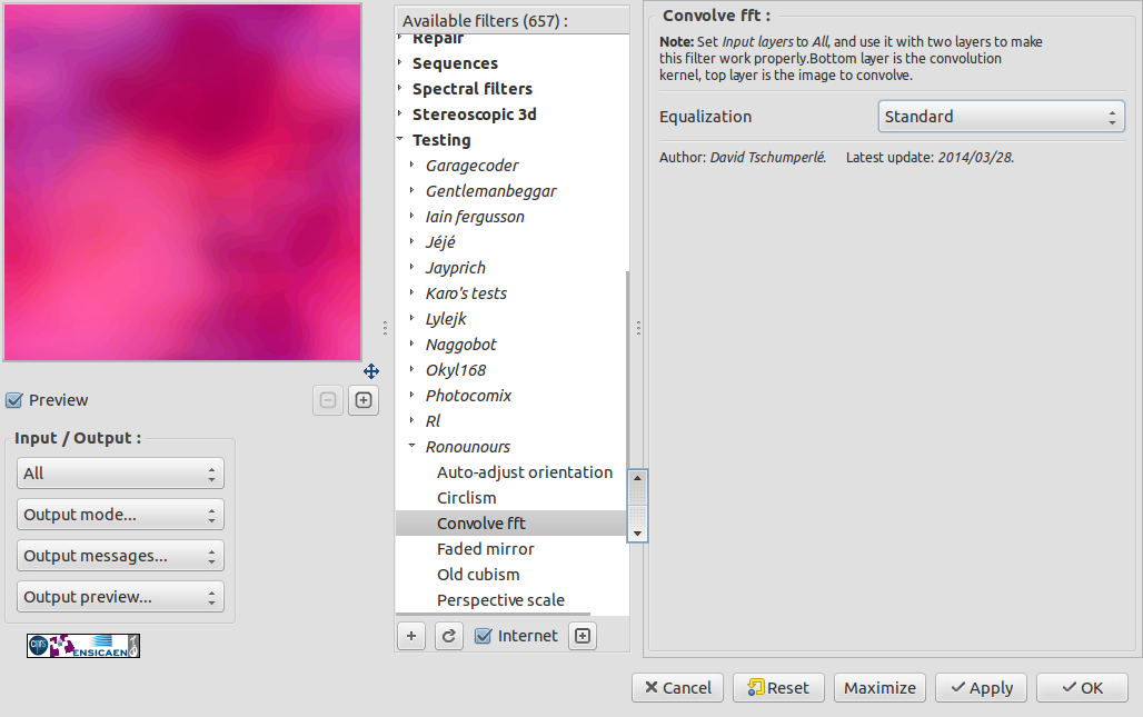

1. Install the G'MIC plug-in for GIMP.
2. Open two images as two different layers.
3. Open G'MIC dialog, press the 'Update filters' button.
4. Go to 'Testing / Ronounours / Convolve fft'.
5. Select 'Input Layers' -> 'All'.
6. Click 'OK', you should get your convolved result.
It's not there... i find a bunch of others under "Ronounours" but not that particular ones..... is there no simple convolution utility that doesn't use FFT though?
 Post subject: Re: Full image convolution
PostPosted: Fri Mar 28, 2014 8:28 pm  (#13)
Joined: Mar 10, 2014
Posts: 845
the new filter is working after the refresh button in Gmic
