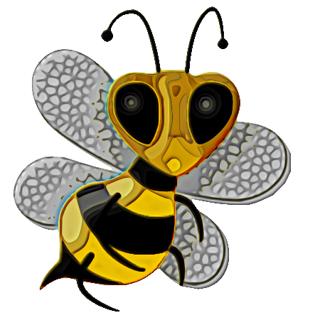

I am finishing a animation each image is a frame each with several layers all layers have transparency (except the BG )
example ( usually there are 4 or 5 layers,i used here only 2 to simplify )
1 layer of the first image
mow i add another layer on top , and this the visible of the first image

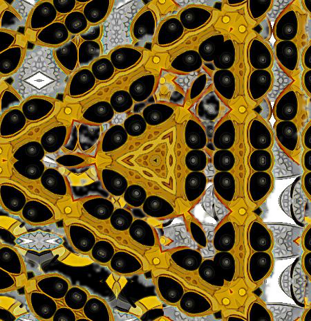

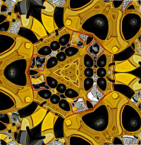

i say are frames, in each image layers are more then 2 all rotating along same center but with different speed and direction
anyway i need to mirror all the layers in each frames so this woulf be the correspondent still.
but remember that along the frames each layer rotate with same center, but different speed and direction
Then mirror each layer allow
1 to multiply image size without loosing quality
2 to multiply the centers of the moviment mantaing a perfect simmetry

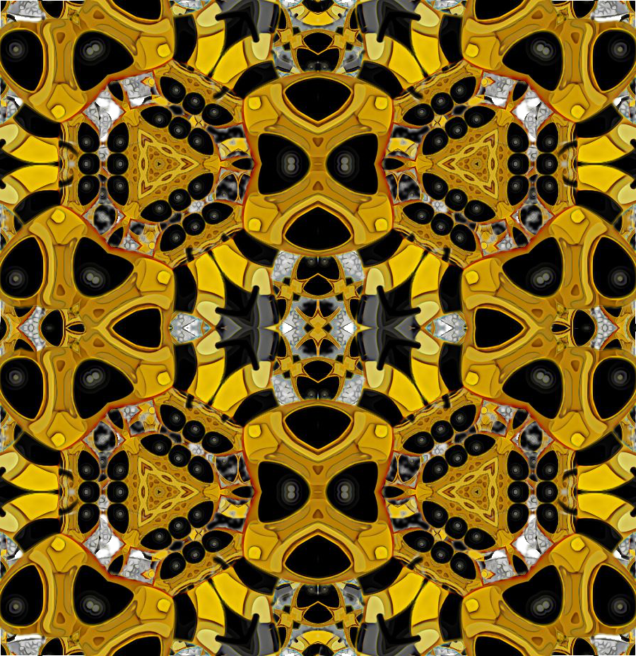

yes it was your i modified a bit
I am tryng to make a video tutorial for 3D looking kaleidoscopic animation.
the basic idea is
1 found a good source should have large transparent part.
source image should have large transparent part, and should be rectangular largest side should be at least 1.5 bigger then smallest
2 duplicate several time the source
3 apply kaleidoscope with different setting on each layers,
taking care to reduce overlapping of transparent area
4 add a soft drop shadow at each layer
5 rotate each layer as required for each frame
6 from the center crop the square (large as smallest side of the rectangle )
7 now all layers have same size and position
8 Here i must mirror all layers in both directions
final postwork just some panning and zooming and the final crop at 16:9
