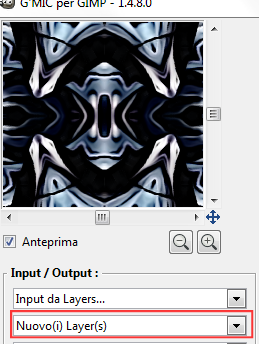

it is not hard at all but is not a filter but a generic gmic option
you may use "new active layers"
there is also a "new layer" option there but with "new layer" option the original remain the active layer, so mayber you will prefer "new active layers"

In any case is not needed undo and redo
In case "copy" + Undo (undo never undo "copy" )+ paste as new layer
...if the filter was slow and/ or didn't preserve last settings used , copy+undo+paste as new layer will be quicker
