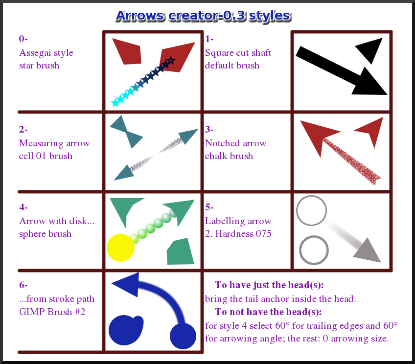

File comment: Style examples

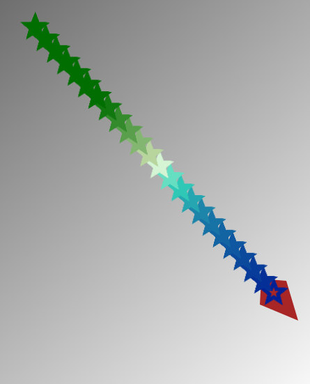

So a photo will illustrate why I consider it more flexible than before.
Without exiting the plug-in, the size of the 'star' brush was controlled with the plug-in brush slider.

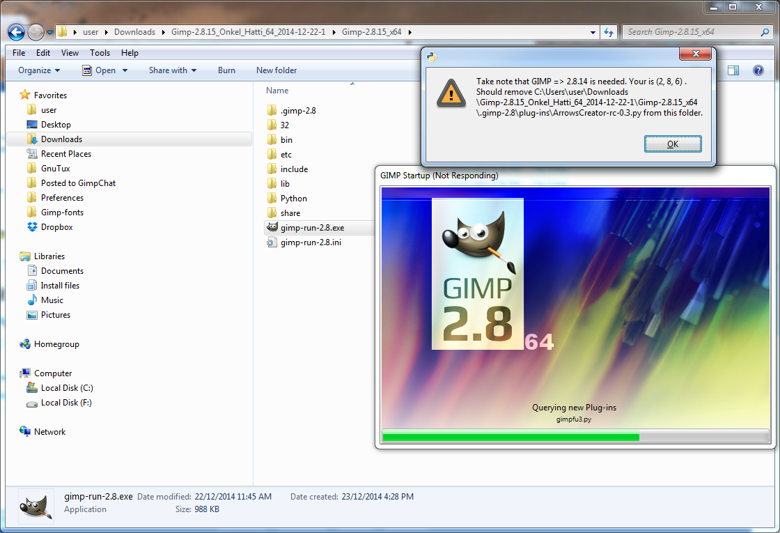

rob_brz1 should ArrowsCreator-0.3 be able to run on 2-8-15

I hope someone with python skills can help me fix this, because the .py file does not know what to do with 2.8.15 and fails

Hi Graechan,
If you refer to the samj's build. When I tried it, no. Then tried the simpler python plug-in included with it as user to no avail, got a little farther as administrator but could not complete.
So I believe it's an install problem not strictly a python language one.

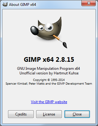

PostPosted: Wed Dec 24, 2014 4:06 pm  (#13)
Rod and rob_brz1 it's a portable build of 2.8.14 I just got from a friend,ArrowsCreator-0.2 works but not 03, note (gimp-version) = ("2.8.15")

Hi Graechan,
If ArrowsCreator-0.2 works well it means that version has not the new brush behaviour of my GIMP 2.8.14 .
The "Take note ..." message is from ArrowsCreator-0.3 because 'gimp.version' has return (2,8,6);
that test is at the line 83 of the code.

PostPosted: Wed Dec 24, 2014 5:36 pm  (#15)
it does have the 2.8.14 brush behaviour, I can grow and shrink brushes at will are you sure it's not looking for 2.8.14 instead of 2.8.14 and above
I have ran a script-fu that has to differentiate between 2.8.14 and below and it functions OK

Hi Graechan,
Then if you want to run AC-0.3, I suggest to comment out line 83 to 86 by putting a '#' at the beginning of each line.
if version < (2, 8, 14) :
    mssgBox("Take note that GIMP => 2.8.14 is needed. Your is %s .\n"%str(version)\
    +"Should remove %s from this folder."%fi)
    sys.exit(1)
It look for below that's the reason of the message, my theory is that build use an older gimp.py module.

PostPosted: Wed Dec 24, 2014 7:14 pm  (#17)
Way to go, that did the trick All is OK now thank you for your assistance. :jumpclap
yes I,m using 32bit py because the new py wouldn't work in portable yet
