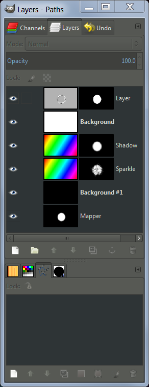

I ran the Alpha to Logo Chrominium Script on a circle and these are the layers it produced.

PostPosted: Sat Jan 17, 2015 5:09 am  (#9)
Posts: 14225
Thank you Sallyanne, this helps. :tyspin :)

Wallace wrote:
sallyanne wrote:
Thanks Wallace. I wrote over the script too.
It isn't working for me in Alpha to logo all the way yet. I am getting a few layers but it doesn't look finished.
Should I wait a while (usually there is a bar moving along the bottom of gimp if something isn't finished) there is nothing there.
I'll try it again tomorrow. I got all of those layer but it didn't have black as the background or a shiny top layer. My gimp may need a rest.
By the way I didn't change any settings....I just ran it default.
