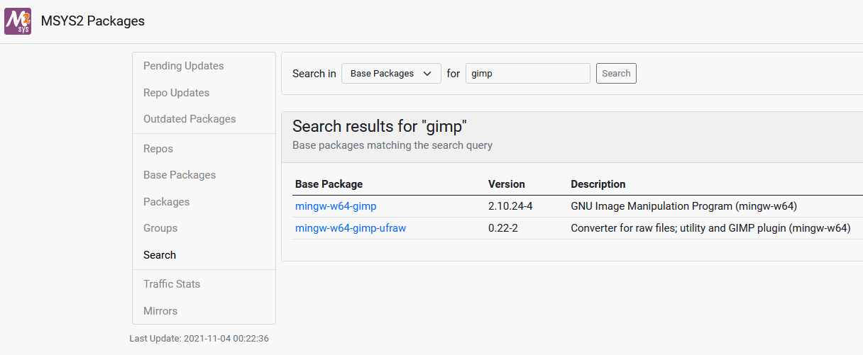

Can be downloaded ( https://packages.msys2.org/queue ) - but this is not the latest version (which may cause problems with inappropriate dlls later). Own compilation highly recommended.
How to compile https://wiki.gimp.org/wiki/Hacking:Building/Windows (also not quite up to date).
