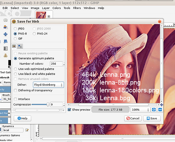

Your problem will be a 'universal' format so first sticking with png.
This is from the tinypng web page
..24-bit PNG files can be converted to much smaller 8-bit indexed color images.
and you can do that with Gimp manually or use the old Gimp save-for-web plugin
http://registry.gimp.org/node/33
save-for-web looks like this with some file sizes for comparison.
the original Lenna.png,
256 colour indexed png,
the number of colours reduced a little to 180.
Then of course there are much better new (and unpopular) formats such as better portable graphics (bpg) which beats indexed hands down for size and quality.
http://bellard.org/bpg/ and a gimp plugin that opens them. http://www.mikropunto.org/?p=71
And there is jpeg2000, gimp will open but not create. You could use something like XnView to make them.

I've actually never heard of .bpg, but just looked it up and it seems to be so much better than jpeg. I'm surprised why no browser supports it. I just followed your tutorial, which was excellent with the screenshots. While it did reduce the size my photos in png-8, there was something extra TinyPNG did to compress it much more. I think I read that they use something called pngquant to power their service.
