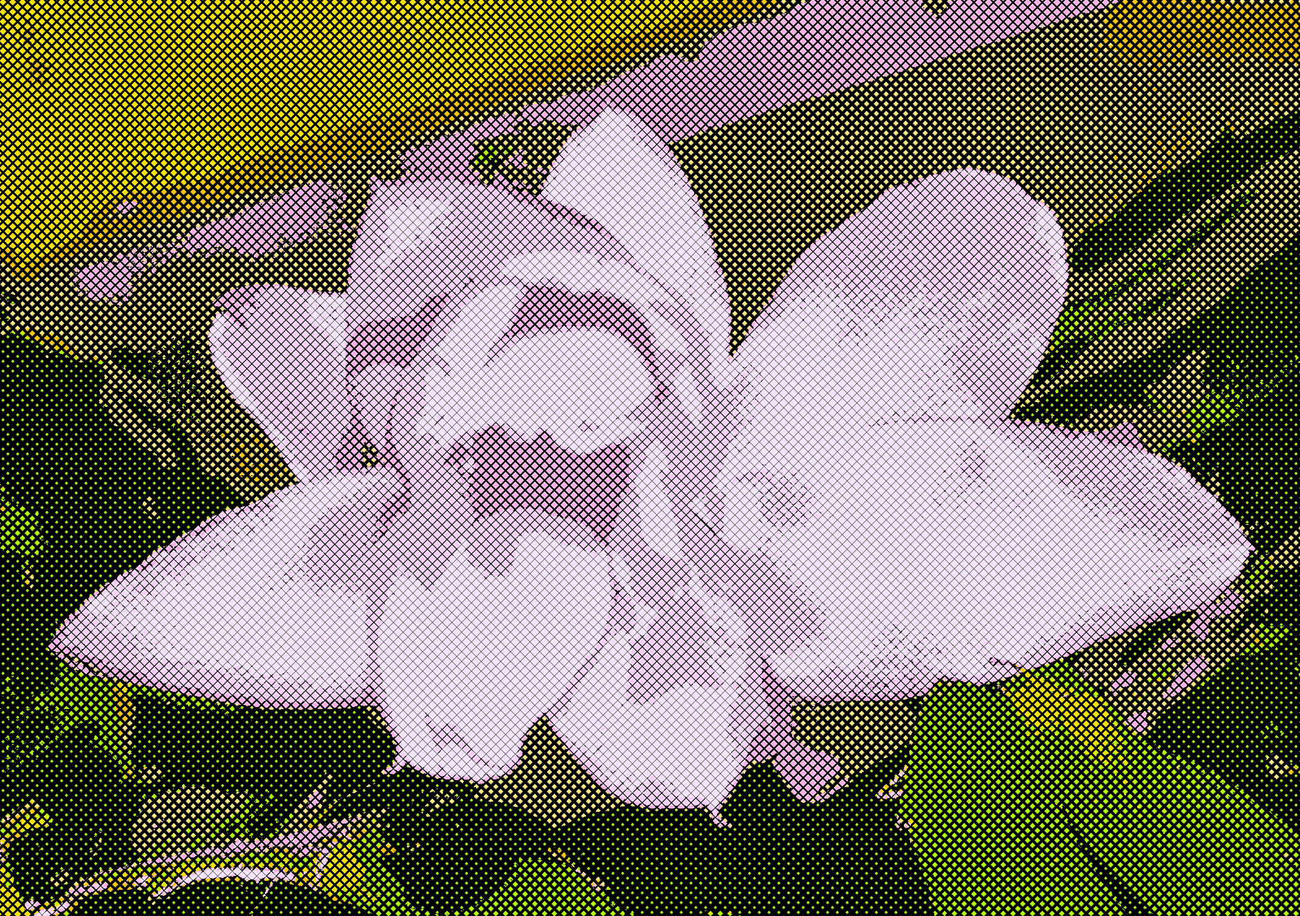

PostPosted: Wed May 27, 2015 9:30 am  (#11)
the outcome using defaults as shown

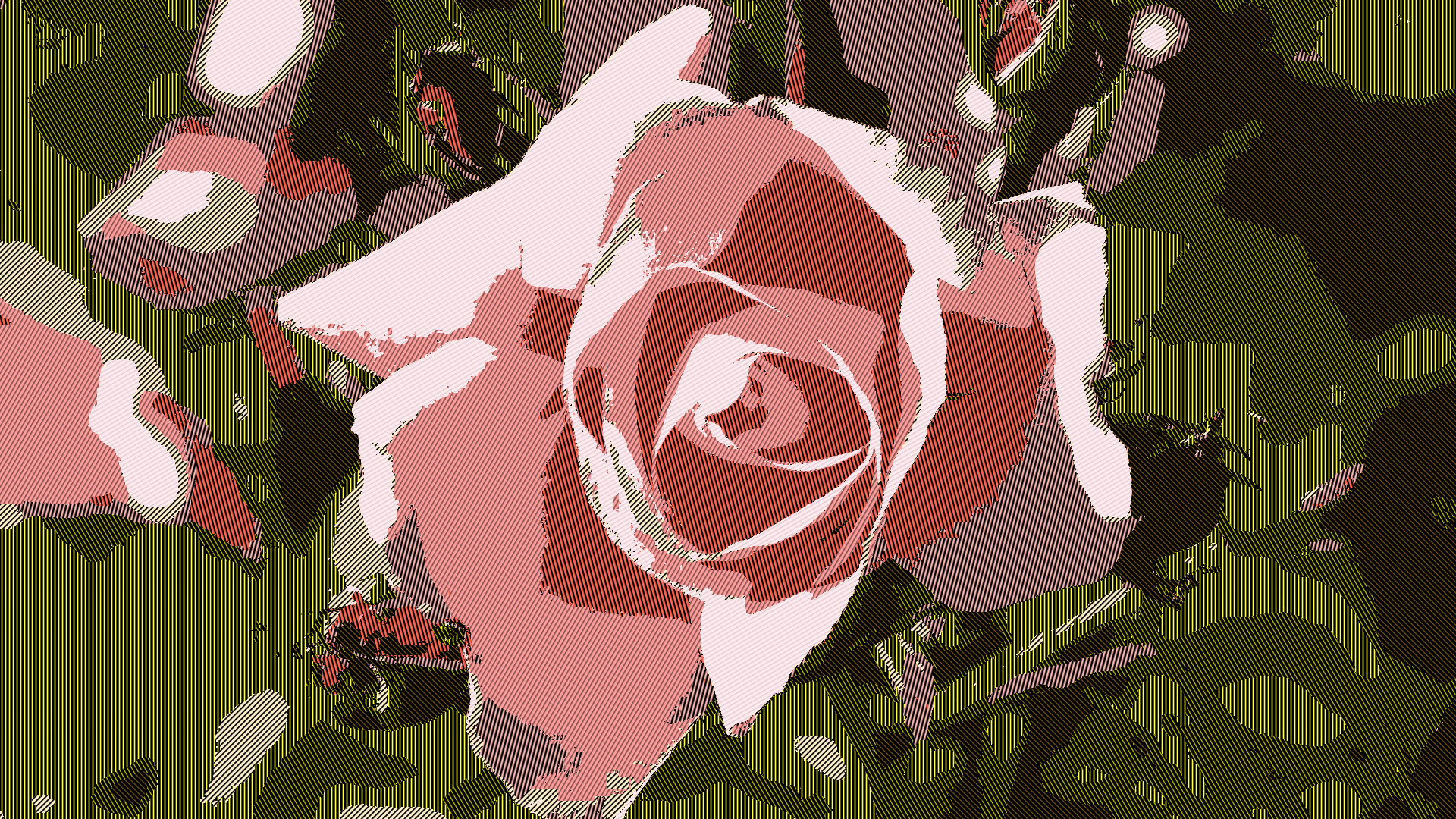

 Post subject: Re: Auto Hatch Layers (will hatch your whole image)
PostPosted: Wed May 27, 2015 9:48 am  (#15)
using a better source image
