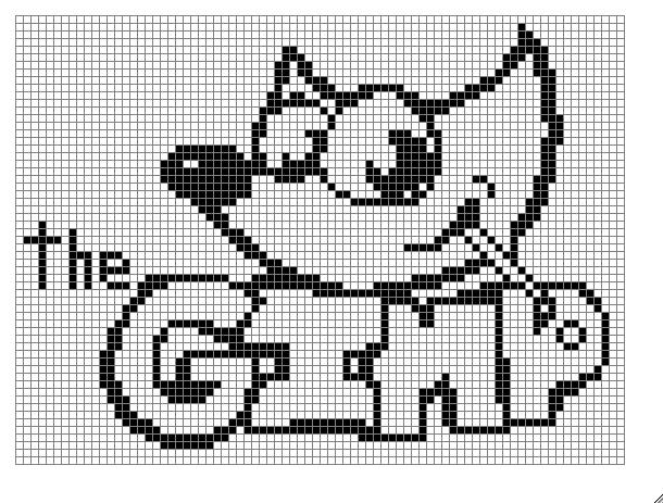

For what it's worth, here is the output of my script.
First, the image needs to be placed within a grid where each cell represents a "stitch".
cinci-grid.png [ 850 Bytes | Viewed 5334 times ]

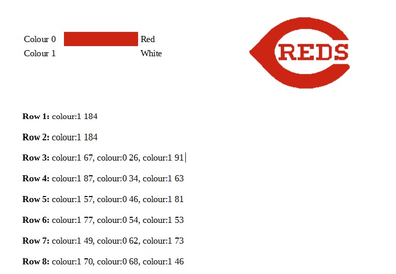

Then when the script is run ("File->Create->Crochet Pattern by Viktoria"), the following tables are produced. Note that the direction of the stitching alternates between left-to-right and right-to-left.
