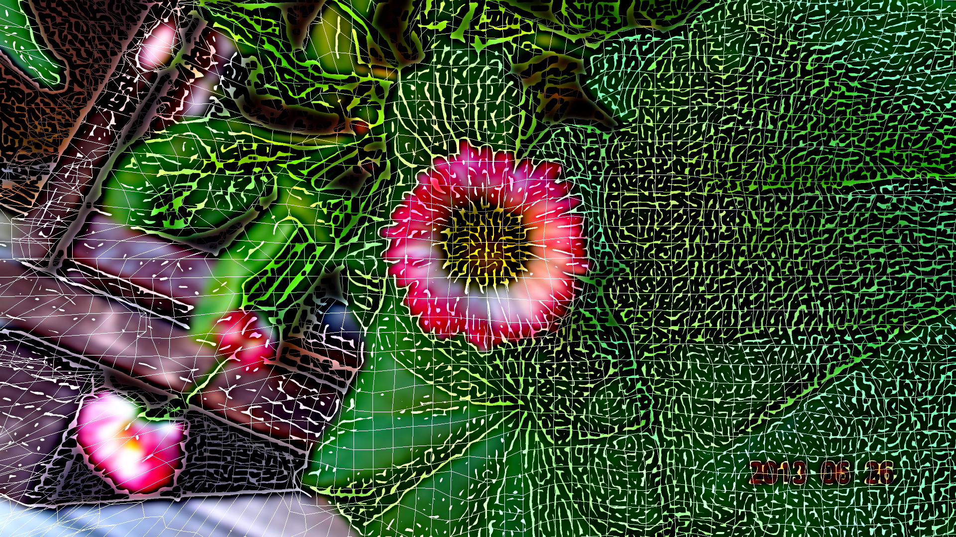

Hello friends.
Finally the effect works.
Thank you all for your help.
I am attaching two pictures.
Doron.
