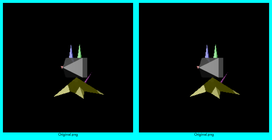

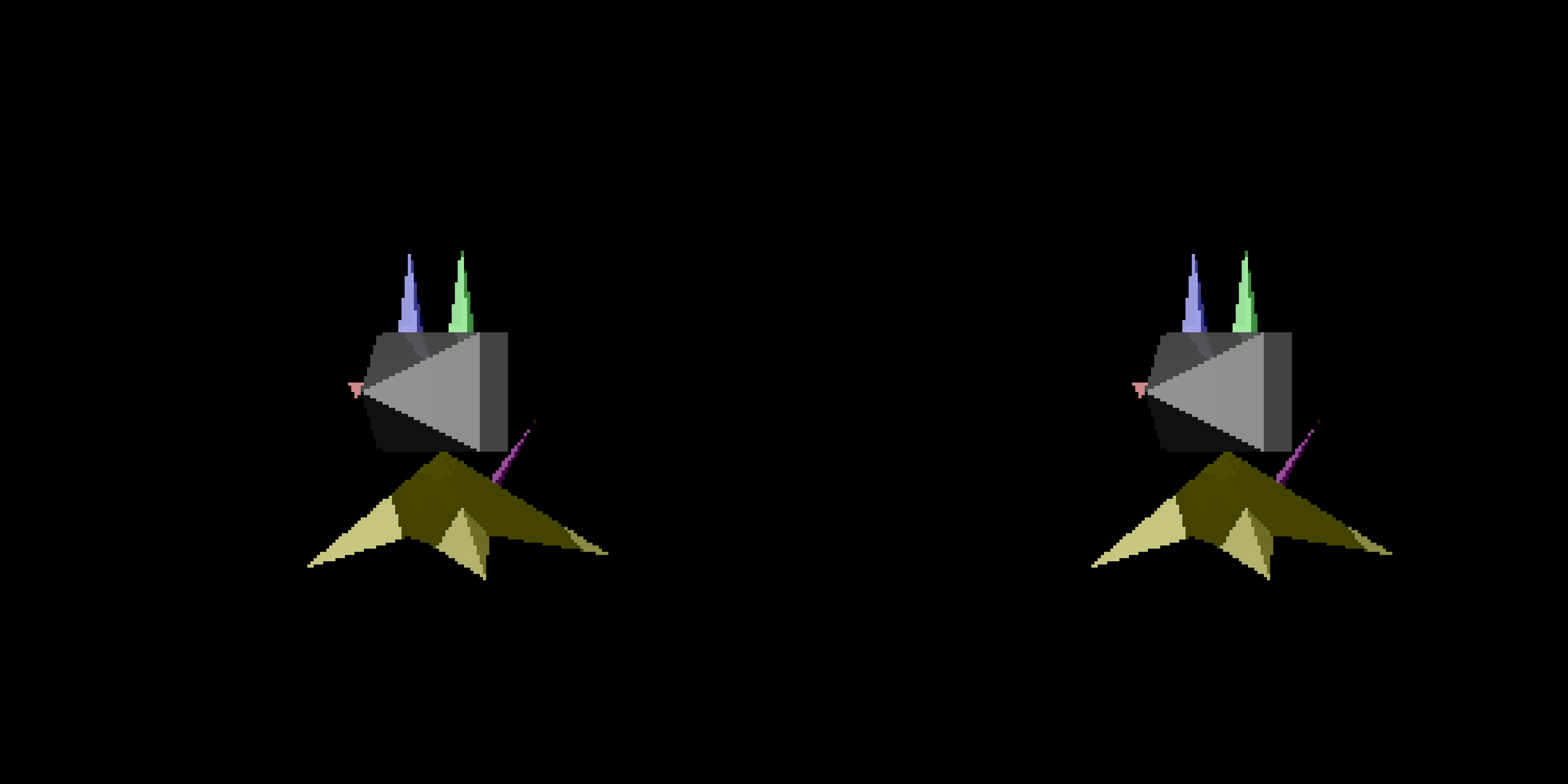

Three uses of ImageMagick "montage" command with the outputs.
montage -geometry '+0+0' -trim -resize 20% Original.png Original.png MontageSmall.png
montage -geometry '+10+10' -background '#00FFFF' -label '%f' -trim -resize 20% Original.png Original.png MontageFancy.png
Original.png is you original image, with white border and all.
When your only tool is a hammer, all your problems look like nails. :)
