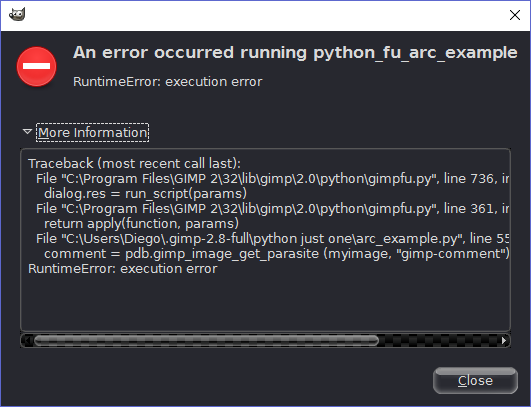

look, Tin

that's freakn weird man, it runs fine on mine

Looks like you have introduced a syntax error after it registered... did you edit it?
Can you run it outside of Gimp (it should say "ImportError: No module named gimpfu")?

No syntax error - the error is what you get when the image doesn't have a comment.

I would have never find this out as I created all my images in GIMP and i think it defaults to have "Created in GIMP" as comment.

wow, that's it
created an image and...voilà, script worked.
IMO this is a bad behaviour by Gimp, it should be amended to answer with something like "no such a parasite" or "void" or "empty", and not conclude with a runtime error or whatever error msg
