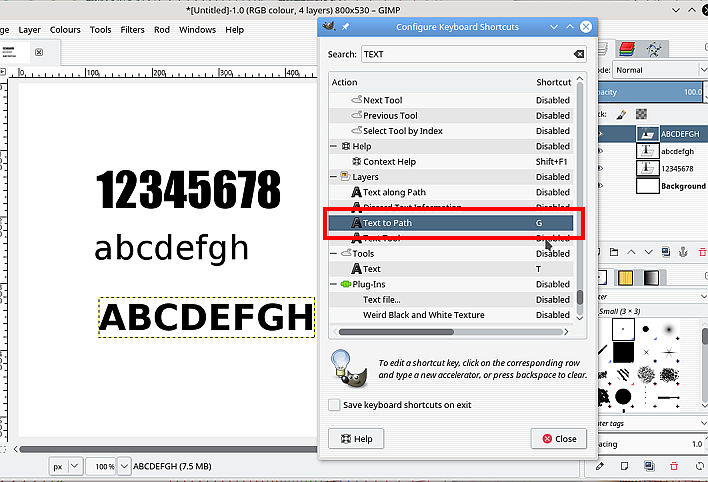

Posts: 2629
Using the above script you can still just arrow up or down in the layers list and hit Ctrl F to redo the filter.
You can't do that with "Text to Path" :)
Assign a shortcut key
