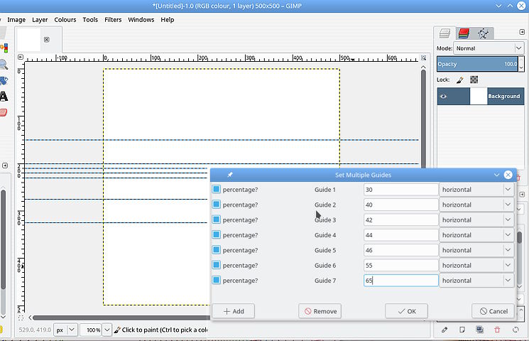

PostPosted: Sun Sep 25, 2016 3:32 am  (#6)
Posts: 2629
There is also this one: http://registry.gimp.org/node/87 which is the original in German. Easy to translate but has been done for you
see: viewtopic.php?f=23&t=13633&p=184897&hilit=add+multiple+guides#p184897
Could be useful in that the divisions need not be regular.
Unfortunately, does not save the layout. (gattools does) and the remove button is there to fool you, only removes the last entry from the dialog.
