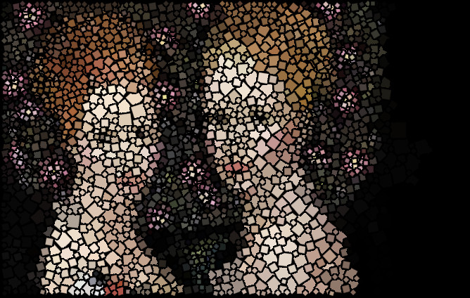

This is it done, posterized to 4 colours, cartoonized, and using square shapeism. Of course the background colour is the reddish orange.
Oh and I meant to say the one good thing about shapeism is it contours your picture. You can especially see it on larger pictures.

me too, I like G'MIC Shapeism
an attempt

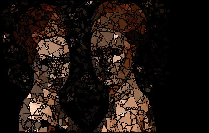

 Post subject: Re: Shape Mosaic
PostPosted: Tue Oct 18, 2016 7:43 am  (#15)
...or this one
