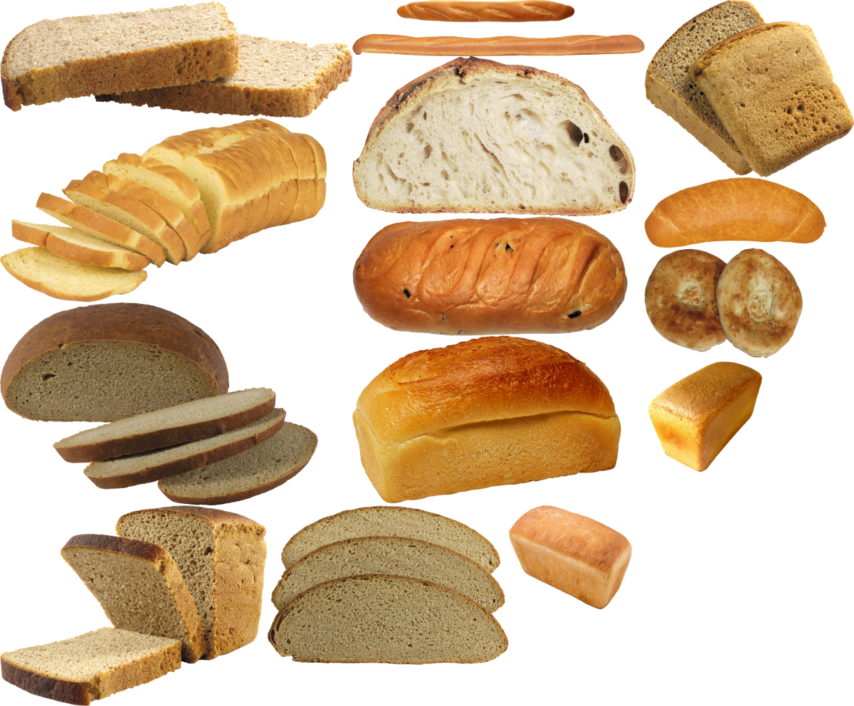

Hi! Is there a script, or plug-ing thingy I can add to GIMP that I can load in multiple images and it generate them all over at random but not overlapping?
I'm working on stuff and I need patterns that look more random.
Thanks! :D

G'MIC has a collage capability like this, Moko, but I've not played with it. :)

Took some bread PNGs and opened them as layers and then ran the G'MIC Pack option (under layers in G'MIC) checking the mostly square option. Of course, I downsized this result since I saved it with transparency (PNG). :)

ohhhhhh that might be prefect!
I've never used G'MIC. I'll have to look in to this in more detail in the morning. Thanks! :D
