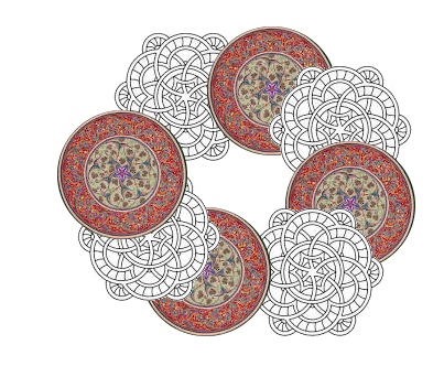

Hallo,
I got a question on a German forum:
If you arrange pictures in a circle partially over the other the last one is
over the first and over the last but one picture:
To get it OK one can use "alpha to selection" and Ctrl-X on the (correct) layer.
My question is now: what are the Python commands to be able to automate this action I tried something like this
pdb.gimp_image_set_active_layer(img, img.layers[-2])
pdb.gimp_image_select_item(img, 1, img.layers[0])
layer -1 is the background layer -2 the first picture and naturally layer 0 is the last
one overlapping TWO picture, but it should do so only with ONE.
What Python command(s) could be used in place of Ctrl-X ???
File comment: one picture not OK
The upper grey Mandela-picture should be over the left one picture.
Creating from two (or more) pictures a Ring like this is done in the Python console.
Only the two commands, possible in the Gimp-window "alpha to selection" and what Ctrl-X (on the right layer) would solve my problem ;)
Your wisdom for me would make (grandfather) Peter happy

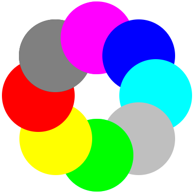

let me think more about it but I would completely avoid the problem bu doing it differently. If I need to arrange 8 pictures in a circle: 1..8 then I create a 9th picture which is a copy of the first with one half made transparent:
See attached XCF.
Overlaps.xcf [57.29 KiB]
Downloaded 131 times

ofnuts wrote:
Otherwise I think you need pdb.gimp_edit_clear() (which is more like [delete] but this should be enough)
Your idea onuts of using a half of a suitable picture works nicely. Thanks ;)
the gimp_edit_clear() , as a replacement for ctrl-x after an "alpha to selection"
seems not to be the real needed analogon. Or I do not do it yet correctly.
Peter
