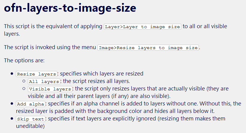

Only informative about a great plugin by Ofnuts
Really a very useful (For those who are looking for this solution for a group of layers (and omissions according to the selection of the text group).
https://www.gimp-forum.net/Thread-ofn-layers-to-image-size.
It should be a permanent addition :yes

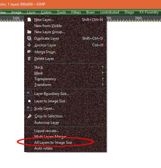

Doesn't GIMP already have all layers to image size built in? I have this option. :)
 Post subject: Re: Layers-to-image-size (by Ofnuts)
PostPosted: Thu Mar 22, 2018 2:08 pm  (#5)
Not a standard one... And AFAIK these old scripts don't handle layer groups.
PostPosted: Thu Mar 22, 2018 2:14 pm  (#6)
Posts: 2629
As Ofnuts reply +
It is an external script, that one I think the fence-post all-layer-to-image-size.scm There is another AllLayersFitToImageSize.scm
Both of those are quite old, do not work on layer groups and flatten the layer, losing transparency.
