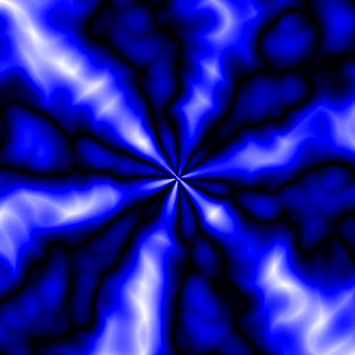

I am posting this script found on a web site that seems to be innactive, it has been updated to run on V2.4
but gives an "unbound variable" error whenever I select the Volute Abstract option.
I do not have the expertise to debug this. The link is for the luminescence script
plus the error image of what i get from the Volute Abstract portion.
The scripts are fronted by a menu that also does not work properly and i think was added later.
Hoping someone can help or advise!
http://abcdugimp.free.fr/gimp/telecharger/scripts/spoon-download.php

The author has defined a procedure name 'script-fu-luminescence-volute-abstract' yet when he registers the procedure he uses the name 'script-fu-abcdugimp-luminescence-volute-abstract'. It is this mismatch which is causing the problem.
The solution is to change the name of procedure being defined. Do you have the expertise to do this?

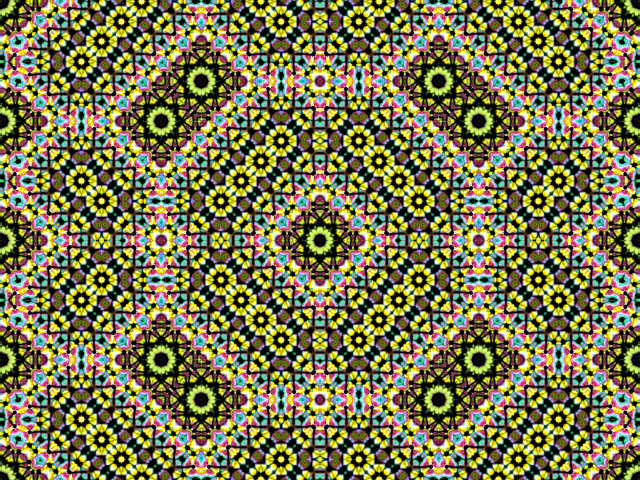

First a teleidoscoped image run through G'MIC's regular array filter, to make it entirely seamless:

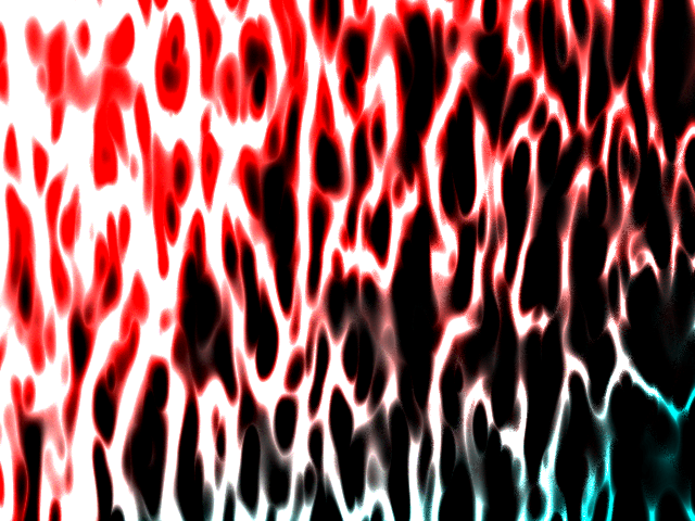

Then I use the Luminensce script to create some funky pattern (I really wish that scripts could leave layer ID on what script performed on it, life would be so much easier in making tutorials). This was the Reflet option and I set the width and height to reflect my original teleidoscope image, and used a bit of unsharp mask to enhance it:

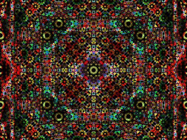

Then pasted the resulting image as a layer on my original, performed G'MIC regular array and set layer mode to overlay:
It gave the original image some much needed depth.
