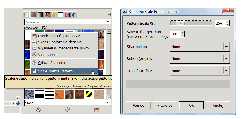

scale_pattern_Gimp-210.zip [2.04 KiB]
Downloaded 459 times

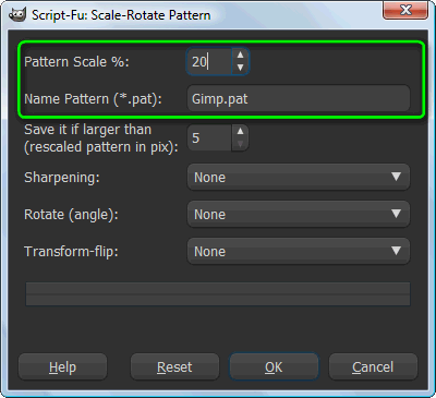

scale_name_pattern_Gimp-210.zip [2.05 KiB]
Downloaded 411 times
