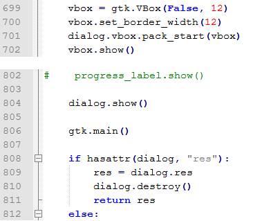

I think a mistake in annex (not the new file) ?

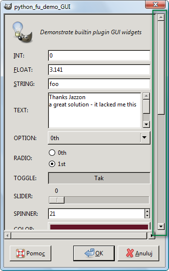

 Post subject: Re: alt-drag and non-scrolling plugins
PostPosted: Thu Feb 25, 2016 8:04 am  (#4)
After making changes works well.
A great solution - it lacked me this.
Thanks Jazzon.
