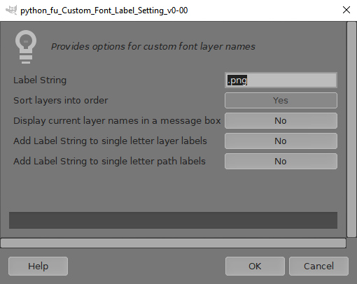

The plugin dialog has four options which work with a custom font xcf file:
Option 1 re-orders the existing letter layers (more on this later);
Option 2 displays a list of the character layers as characters (ie space.png is shown as space) in a message box. You can easily check for missing layers or see which characters are available in a font without scrolling through all the layers.
Option 3 adds .png to all the single character layer names in the file. (I am too lazy to type all those extra .pngs when creating fonts from scratch so I leave them as a single character and use the filter to add the file extension letters for me.
Option 4 adds .png to all the single character path names that exist in the file.

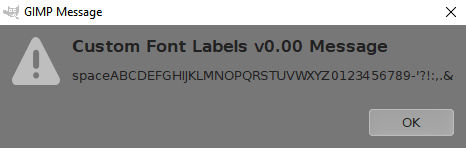

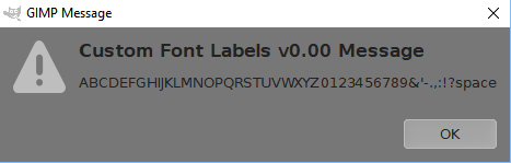

Option 2 run with Blue_Gold Custom Font before re-ordering.
Option 2 run with Blue_Gold Custom Font after re-ordering.
Not a lot of difference with this existing custom font - but note the space is now the first item in the list.
