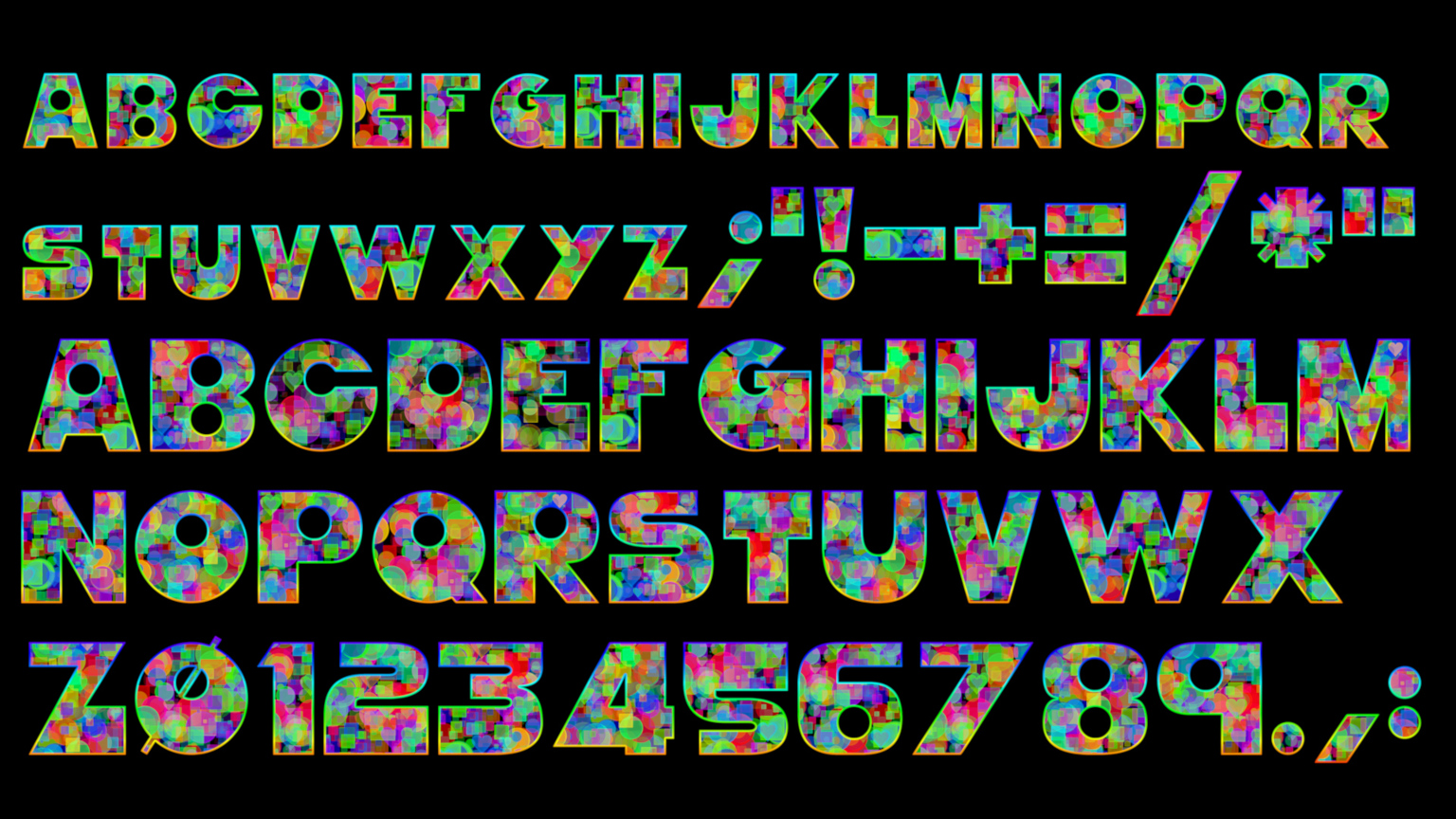

And this is the custom font I had the original idea for - without any shining up or bevel added. Save that fun for another day.
