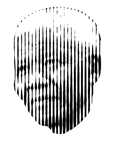

Here is the image I created.
My steps were: Open an image: Scale to, say 900 x 900 pixels -- Then Save
Scale the image to 200 x 200, rotate 90 degrees CW, apply Engrave filter
Rotate image by 90 degrees CCW. Scale image back to its original size.
As the Mandela memorial was created by solid Iron Posts, the 'lines' are thick. But in the image I created I was not able to make lines quite thick. They appear as thin lines drawn with black pencil and makes the image as a drawing and not as a picture of a 3-D structure. I could not make the lines fairly thick.
I am attaching the picture created by me.
-Eureka

Newsprint filter, not Engrave !
The monument is imitating a 3D halftone effect.
The Newsprint filter is for making halftones !
Use the line option.
Theres also a way to create this effect manually.
Look here:
viewtopic.php?f=4&t=8713
