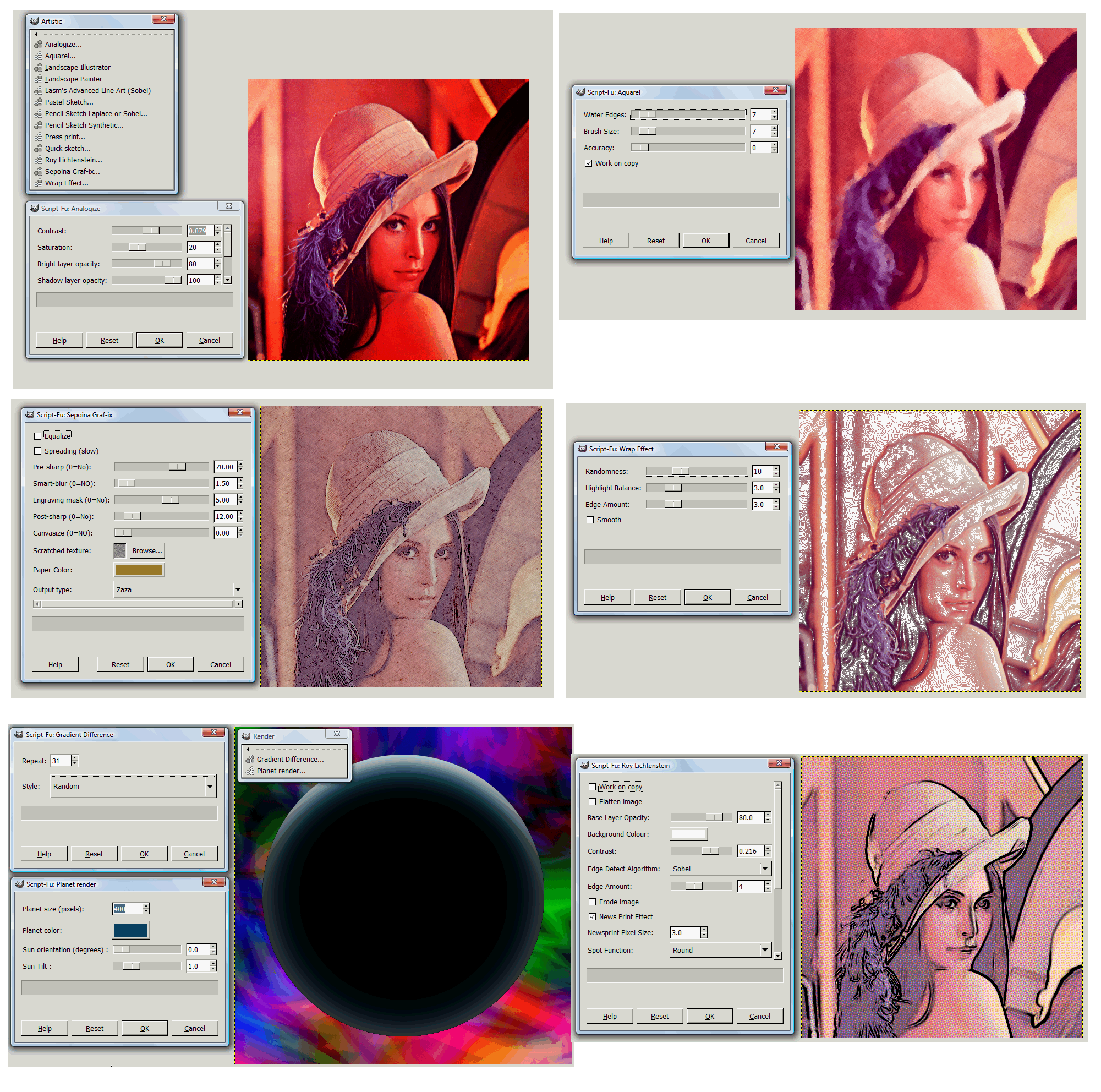

@mackenzieh
Some fun with these name - you have to look for it...
Example:
by Paul Sherman: name script: 210_sketch_Roy-Lichtenstein.scm; in menu: Script-Fu/Sketch/Roy Lichtenstein
by Gimp FX Foundry: name script: cprogrammer-roy-richtenstein.scm; in menu: FX-Foundry/Photo/Effects/Roy Lichtenstein...
@Pocholo
Your method is faster than mine - step by step. It lasted 30 minutes.
A lot more time is needed for tests after changes and looking for solutions for possible operating errors.
Scripts FX Foundry use plugins that no longer exist in Gimp 2.10 (replaced by Gegl filters):
- edge-sobel.exe
- edge-laplace.exe
- blur-motion.exe
- blur-gauss.exe
- blur-gauss-selective.exe
The solution to this problem is to copy these files from the GIMP 2.8 version.
Files 32 bit in the attachment (but I do not have 64 bit - can someone attach them here?).
For obvious reasons, FX Foundry scripts use deprecated procedure.
Gimp 2.10 ignores them, but probably only temporarily - so I tried to update them.
To test in Annex the 15 scripts (13 in the Artistic category, 2 in the Render category).
ps.I do not like script-fu and I prefer to learn PYTHON...
Plug-ins for FX Foundry-Windows_32bit.zip [98.31 KiB]
Downloaded 293 times
Scripts FX Foundry_GIMP-2.10.zip [33.63 KiB]
Downloaded 513 times
