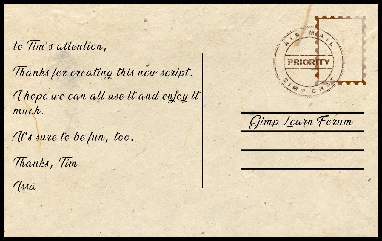

 Post subject: Re: Distressed Rubber Stamp Plugin
PostPosted: Thu Mar 14, 2019 10:32 am  (#5)
Posts: 14237
Thank you Tim, good ideas to use it. :hehe
PostPosted: Thu Mar 14, 2019 10:44 am  (#6)
Posts: 4561
Thanks Issabella, That's a nice use (not a fake passport, lol).
I was wondering with version 4, there's option to leave mask unapplied so that you can manually use a different mask for distressed effect.
If you find a good or better (1000x1000px) .png to use as distressed mask please share.
I am only about 65% happy with the distressed .png that I got in the plug-in. I think it could look much better but I find it hard to create distressed png.

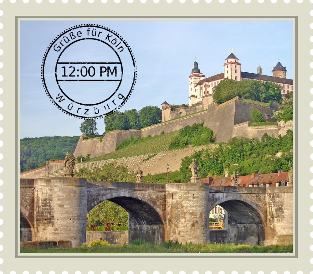

PostPosted: Mon Mar 18, 2019 6:45 am  (#13)
This is an old problem with a simple solution.
The text field requires UTF encoding - so for a non-English version you need to add:
   pdb.gimp_context_push()
   #core code goes here/below
   top_text = top_text.decode("utf-8")
   middle_text = middle_text.decode("utf-8")
   bottom_text = bottom_text.decode("utf-8")
   width, height = 1000, 1000
PostPosted: Mon Mar 18, 2019 9:31 am  (#14)
Joined: Sep 27, 2016
Posts: 345
Location: Germany, BW
So easy.
Thanks a lot.
Regards
nelo
PostPosted: Mon Mar 18, 2019 9:48 am  (#15)
Posts: 4561
Thanks MareroQ,
Added this change to v5.
