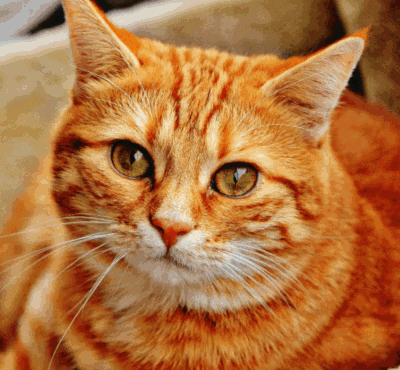

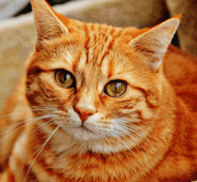

Trandoductin presented very interesting effects for video.
Since Gimp supports the webp format very well, you can use it instead of gif.
It's the perfect format for small presentations/slideshow.

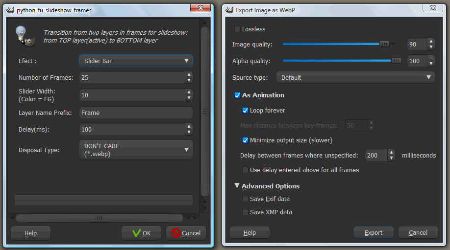

With very good examples of the Tin Tran code, I combined it into one of its three plugins:
Fade Frame Plug-in
https://gimplearn.net/viewtopic.php?f=3&t=2369&sid=cd6929e9f014606b69ce34aac81dc6f9
Slider Animation Script for GIMP (Swipe Animation)
https://gimplearn.net/viewtopic.php?f=3&t=1037&hilit=slider
Rename Layers Script For Animated .gifs animation
https://gimplearn.net/viewtopic.php?f=3&t=72&p=4243&hilit=rename+layers#p4243
I have also added three other effects as an example:
- Cubism+Fade
- Pixelize+Fade
- Video+Fade
but they need old plugins (with Gimp 2.8.22: cubism.exe, pixelize.exe, video.exe) that are available in the thread (thanks to Pat625):
viewtopic.php?f=9&t=17321#p237761
You can use the IrfanView 4.52 program (for Windows) to play as animation webp files:
https://www.irfanview.com/plugins.htm
ps. The extension webp is not allowed. - only gif :gaah

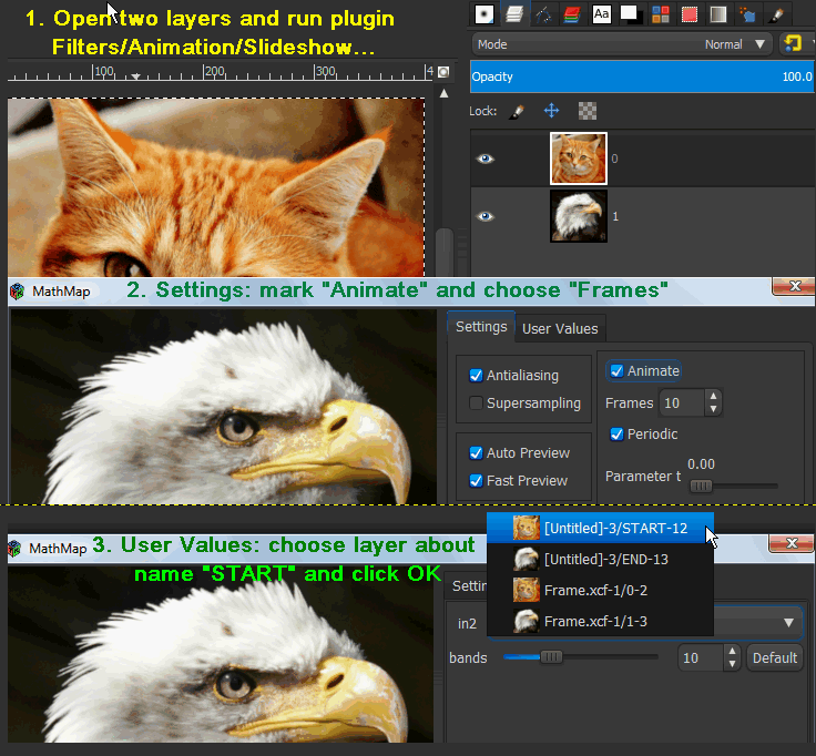

Ver.2
Add efect:
- Slider Bar(from Top to Bottom),
- Ripple+Fade,
- MathMap: Angular Transition 1, Angular Transition 2, Radial Transition, Horizontal Curtain, Vertical Curtain, Zoom and Rotate.
Add option:
- Type of Fill for Slider: FILL-FOREGROUND, FILL-BACKGROUND, FILL-WHITE, FILL-TRANSPARENT, FILL-PATTERN,
- Delay START/END Frame (they should usually be displayed longer than the change itself/efect).
- Group Layers/frames (useful for combining more photos),
- Run Playback(interactive: animationplay).
Slideshow v.2.zip [18.4 KiB]
Downloaded 321 times

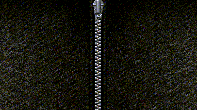

That's perfect Tin, thanks...

Yes this version make it a lot easier to work with, thanks...

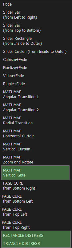

New in Slideshow rel.4:
 Post subject: Re: Slideshow by codes TT
PostPosted: Wed May 22, 2019 4:42 am  (#16)
Rel 4

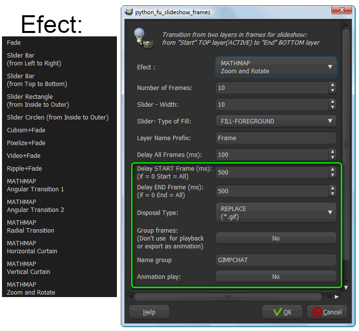

Add new efect:
- MathMap Vertical Gate,
- Rectangle Distress,
- Triangle Distress.
Slideshow v.4.zip [20.25 KiB]
Downloaded 241 times
