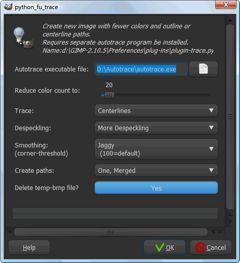

I remembered Plugin-trace.py - I've never managed to run it in Windows.
Now I know that this is due to the type of files supported by autotrace (it does not support png files - I do not know if this is a bug or a change in autotrace) and a few spaces...

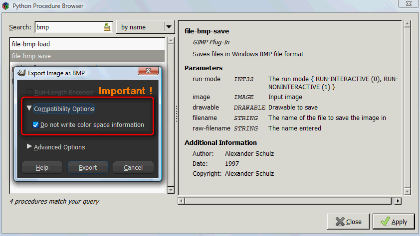

The temporary file is saved interactively - and important (the problem of autotrace or my older version of the 32bit file that supports Win Vista):
In Compatibility Options
Select Do not write color space information.

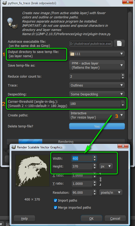

Ver 0.3
Some minor changes:
1.Add output directory to save temp file,
2.Replace "Smoothing" (PF_OPTION) to "Corner-threshold" (PF_SPINNER)
3.Changed descriptions...
plugin-trace-V 0.3.zip [9.29 KiB]
Downloaded 315 times

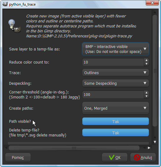

To say goodbye to this topic.
Ver. 0.4
-resignation from the selection of directories ["Autotrace executable file" and "Output directory to save temp file"] to eliminate the problem of spaces in the names
(which autotrace does not tolerate). Requires (for Windows) copying the autotrace.exe file to the bin Gimp directory.
A location was set for Linux: "/usr/bin/autotrace". You can edit in line 185.
-add options: "Path visible?": Yes/No
-the rendered image(layer and path) is named as the source layer (accepts spaces - because the name is given after the autotrace has finished)
plugin-trace-V 0.4.zip [9.03 KiB]
Downloaded 368 times

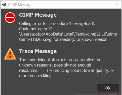

MareroQ, I cannot get Trace to work. I have Win 10, 64 bit, Gimp 2.10.12. I put Autotrace.exe in the Gimp portable bin folder and the Trace in preferences plug in folder. I tried to make outline of a black silhouette and centerlines of a simple design but could not get either. Must be using wrong settings? Suggestions?
Here are the errors that I get:

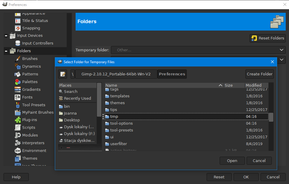

PostPosted: Wed Aug 28, 2019 10:00 pm  (#12)
Hi Pat.
For the purposes of the test:
- in Edit -> Preferences -> Folders, change the default location of the temporary folder to a suitable one for portable:
i.e. for example d:\Gimp-2.10.12_Portable-64bit-Win-V2\Preferences\tmp\
- Gimp restart
- use Trace (Delete temp-file? No, Create paths: One, Merged) twice with the option:
1. Save layer to a temp-file as: BMP
2. Save layer to a temp-file as: PPM
Check the Preferences/tmp directory and let me know what gimp-temp files have been created?
