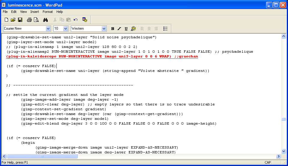

I need some help (have tried everything)to run this plug-in in the script Volute abstraite of
luminescence. I can't get the Parameters for border part right,I put in 0,1,fill,FILL AND even my dogs D.O.B
Still no good
(plug-in-kaleidoscope run-mode image drawable angle1 angle2 nsegs border)
Could someone help with some Guidance or Suggestions.

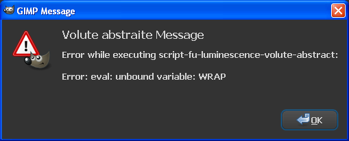

Replace the "WRAP" with a 1.
Evidently "WRAP" is not a defined literal.

As I wrote I tried 0,1,fill ,FILL and even my dogs date of birth.
But I tried 1 again in case I mucked up saving the file before running the script,still to no avail.Do you think there is some thing else wrong in the Plug-ins
parameters and would it help if I posted the entire Script.I do appreciate your reply though. Thank you

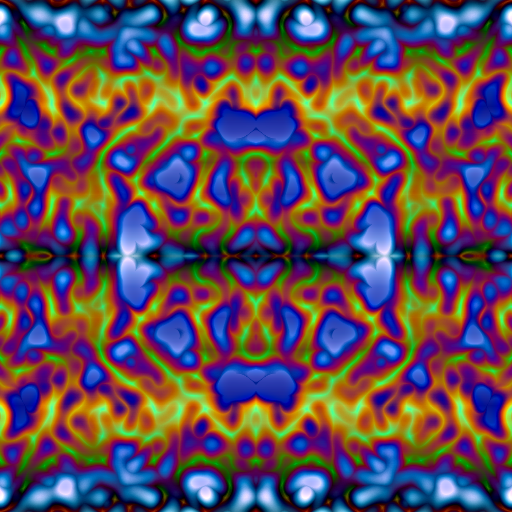

I'll post a screenshot, since I only used one line of code:
I also made alienmap interactive so I could change the colors.

Mahvin this is the image I returned when I shifted the file here and added,
(activeLayer nil) to the let block.
But because its now 'INTERACTIVE'.
It leaves the script-fu-possible-images-luminescence for volute abstaite unusable.
any ideas on that would help.

You removed alienmap2, or I don't see it in your screenshot. Mine works fine.

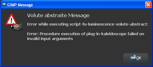

It looks like that's a bug in the Kaleidoscope plug-in. It works if you run it in interactive mode:
(plug-in-kaleidoscope RUN-INTERACTIVE image uni2-layer 0 0 6 0) ;;graechan
It looks like all of the arguments are ignored by the plug-in. :hoh
That's probably why fencepost (Art Wade) ran the plug-in in interactive mode in his animation script.

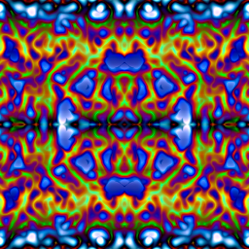

so after a short discussion with my dog I have decided to give GMIC a try,
(plug-in-gmic run-mode image drawable input command)

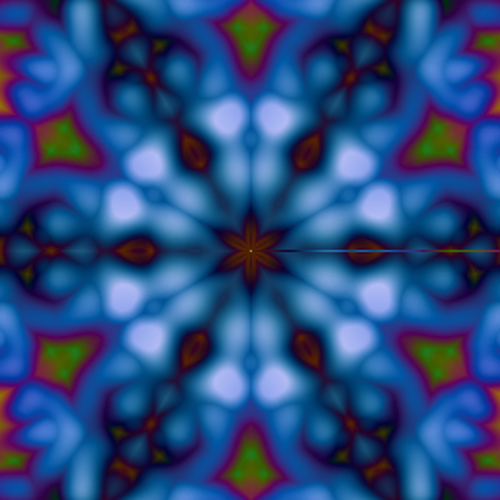

so does anybody know offhand (maybe Lyle would)where the command string can be found. The image I got from mirrored array is below
and a big thank-you to everyone especialy Mahvin who contributed

I think I might have a solution in gmic's mirrored_array.
Just researching the (command string)now.
I cold also use Filters/map/mirror.Its also listed in the procedure browser.

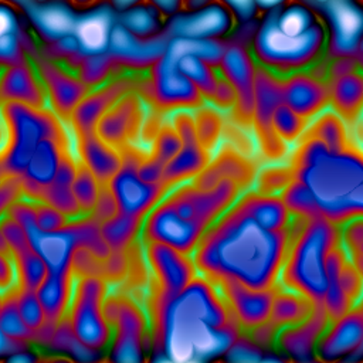

Something that will run non interactive and produce a kaleidoscope like image.
SUCH AS
NOT EXACTLY AS GOOD but sufficient and done with Gmic
OR LIKE THIS
DONE USING MIRROR in filters/map
Ilike the Gmic image more as it has less imperfections.
But I respect your younger eyesight and views on this.
Both of these images created from this
