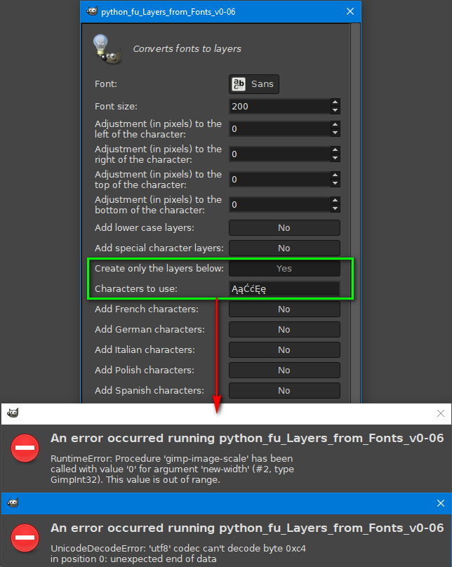

I have only a small suggestion:
When using national characters for "Create only the layers below" gives an error.
To consider:
- adding one line of code:
restricted_case = restricted_case.decode("utf-8")
- replacement of these lines:
    max_width = 0
    max_height = 0
on:
    max_width = 1
    max_height = 1
For me, after the changes it seems to work well.

Thank goodness for people like you MareroQ.
I didn't think anyone actually used the restricted set of characters. But yes it would certainly throw up errors if you tried to use non-English characters in that option.
Bit busy at the moment but I shall certainly re-code that particular one.
