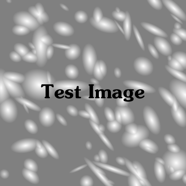

Actually it was one of your Plug-ins that I wanted to call, 'Random Elipses' and it definately seems different.
(python-fu-random-ellipse run-mode image drawable density overlap sizeAvg sizeVar flatAvg flatVar tiltAvg tiltVar)
If it were a Script I'd delete the run mode then place settings I wanted to use in my menu and define block the rest of the settings I'd assign a value in my (let* area.But what do you give for TRUE&FALSE.

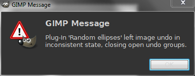

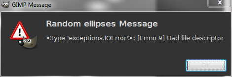

Ofnuts your random ellipses_0.2 Plug-in is giving these errors whenever I run in 2-6-11
The function works OK but the error codes are a worry.
As was pointed out when Ofnuts originally announced this script, it breaks when run on Windows due to printing excess debug messages:
viewtopic.php?f=9&t=1790&start=30#p23056
Didn't Ofnuts fix that though?Seems to me that he did.
My impression was that you fixed your copy. It's still the same problematic version offered for download.
I don't remember. The header of the version I have here says:
#   v0.2: 2011-05-22: Enhance error message to track mysterious '9' bug
Looking at the code, I just chnage the code I execute when I get an exception to print more detailed information. So the problem is acknowledged but likely not solved, because I didn't get significant feedback since...
 Post subject: Re: Can a Python Plug-in be called from Script-fu
PostPosted: Wed Oct 19, 2011 5:49 am  (#13)
Some investigation leads me to believe that it is some external console message interception that does uncouth things with the I/O stream. So I removed most traces, and reorganized a bit the context save/restore so it should not damage the undo stack even if it crashes.
https://sourceforge.net/projects/gimp-t ... s/scripts/

(python-fu-random-ellipse RUN-NONINTERACTIVE image bkg-layer 50 1 50 5 50 5 45 5)
All I need is to replace the numeric values I want to make variable with a string and enter in my menu.
