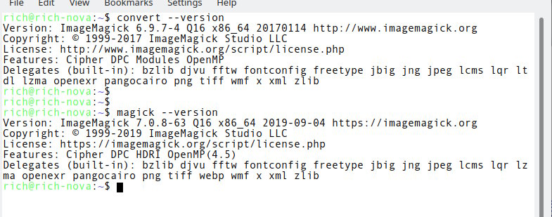

As long as it works, and your script works ok. The horrible tedious ImageMagick story is:
For Windows
convert is already a MS command for converting one file system to another so the IM people changed to using magick. Should work in a terminal like this:
For linux
IM v6 is a dependency for so many graphics applications, making IM v7 a default is a lot of work. So IM v6 remains and so does the convert command.
Have to confess, I keep a home-made IM v7 for some things, webp support for example, and using magick in your script also works.

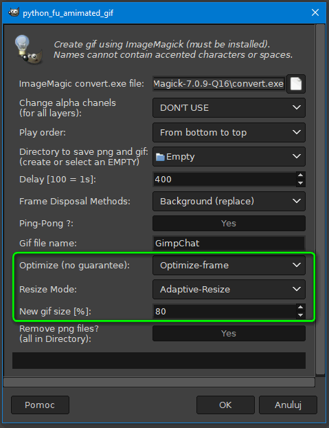

There are various basic methods in ImageMagick of "minimizing" file size in .
Generally optimization of the gif size depends on the type of animation (Disposal Methods and transparency) and the basic methods are:
Deconstruct: find areas that has changed between images.
Given a sequence of images all the same size, replace the second and later images, with a smaller image of just the area that changed relative to the previous image.
The resulting sequence of images can be used to optimize an animation sequence, though will not work correctly for GIF animations when parts of the animation can go from opaque to transparent.
Optimize-frame: Optimize a coalesced animation, into GIF animation by reducing the number of pixels per frame as much as possible by attempting to pick the best layer disposal method to use, while ensuring the result will continue to animate properly.
There is no guarantee that the best optimization is found. But then no reasonably fast GIF optimization algorithm can do this. However this does seem to do better than most other GIF frame optimizers seen.
Optimize-plus: As 'optimize-frame' but attempt to improve the overall optimization by adding extra frames to the animation, without changing the final look or timing of the animation. The frames are added to attempt to separate the clearing of pixels from the overlaying of new additional pixels from one animation frame to the next.
If this does not improve the optimization (for the next frame only), it will fall back to the results of the previous normal 'optimize-frame' technique.
There is the possibility that the change in the disposal style will result in a worsening in the optimization of later frames, though this is unlikely.
In other words there no guarantee that it is better than the normal 'optimize-frame' technique.
For some animations however you can get a vast improvement in the final animation size.
Optimize-transparency: Given a GIF animation, replace any pixel in the sub-frame overlay images with transparency, if it does not change the resulting animation by more than the current -fuzz factor.
This should allow a existing frame optimized GIF animation to compress into a smaller file size due to larger areas of one (transparent) color rather than a pattern of multiple colors repeating the current disposed image of the last frame.
Animated_gif_using_ImageMagick V-0.3.zip [2.67 KiB]
Downloaded 213 times

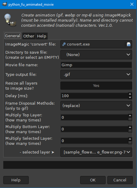

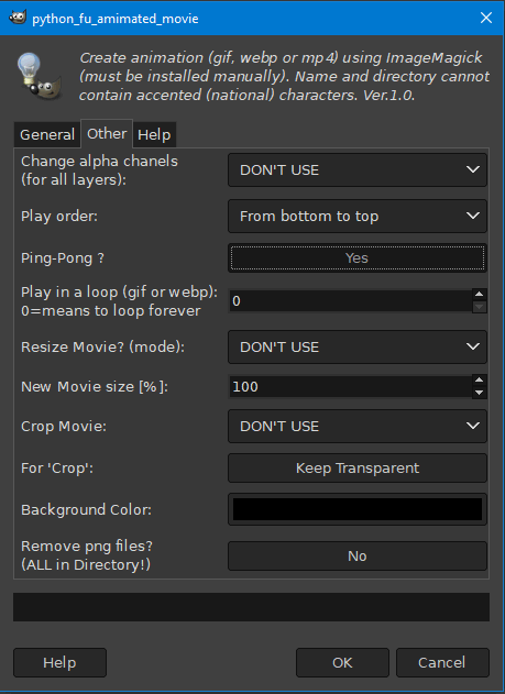

Ver.1.0.
This version was available on gimpscripts.net (but no longer exists).
You don't need to know anything about ImageMagic - download https://imagemagick.org/script/download.php and install ImageMagick-7.1.1-Q16-HDRI to the default location
In menu: Filters ➤ Animation ➤ Animation with ImageMagick...
The frame display time is regulated by the number of frames.
You can save as .gif, .webp or .mp4
