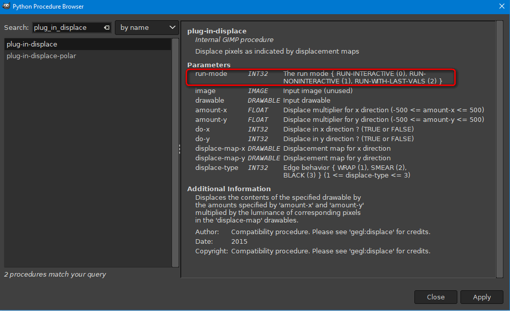

Hi i-regular.
You used the wrong number of parameters - lack: run_mode=......
pdb.plug_in_displace(img, tattoo_layer, 10, 10, True, True, disp_drawable, disp_drawable, 2, run_mode=RUN_NONINTERACTIVE)

Thanks - I forgot to tell that I was running the plugin from within GIMP, so I believe in that case I do not need to specify the run-mode? But, I will need to run it later from batch, so thanks for pointing out!
I found the issue. There seems to be an error in version 2.10.14 of GIMP where the procedure does not work. I just upgraded to version 2.10.18 and now it seems to work also without specifying the run-mode i.e. with no modifications to the code above. Also I tried version 2.8.22 of GIMP where it also works!

MareroQ wrote:
Hi i-regular.
You never *need* that run_mode parameter. It's a named parameter because it is optional in the Python API (and defaults to RUN_NONINTERACTIVE, so you typically only use it with RUN_INTERACTIVE). The doc mentions it because the Python doc is built from the Scheme one, but there are mappings between the Python and Scheme.

... the Python doc is built from the Scheme one, but there are mappings between the Python and Scheme
This is what I understand now why in script-fu this is the first parameter and in python the last - if needed (because erroneously indicated in the Python Procedure Browser also as the first by stupid analogy).
Thanks for the clarification.
