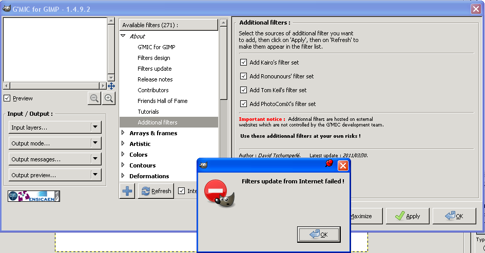

It is probably a new problem. Did you try to refresh the filters GMIC today?
Just a few days ago it was OK. (XP 32 bit)

PostPosted: Wed May 25, 2011 12:32 pm  (#10)
David asked to rename the file, i just renamed mine i hope was not that to broke something
Also I still have a files tranfer going on, not sure if the server wait the end to the transfer (that could take a while
Anyway to check if that try to uncheck my source , repeat and see if the problem remain
 Post subject: Re: G'mic problem loading additional filters
PostPosted: Wed May 25, 2011 12:44 pm  (#11)
Posts: 2639
This is it. If you deselect - Add PhotoComiX's filter set - working properly.

PostPosted: Wed May 25, 2011 12:47 pm  (#12)
Posts: 12775
Just tried that PC; you were the culprit. lol
Still not getting updates with you checked, so don't know what the issue is other then your connection uploading is way too slow and still your changes are causing some issues. :)
