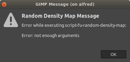

However when I've tried Rob's Random Density Map, using a new layer, and indicating a grayscale "density map" in the dialog while leaving the other _3_ visible options (#points, border margin, bailout threshold) at their defaults, running it with "OK" results in an error message:

I should have thought to attach a screen shot too, for comparison, and I'll remedy that as well.

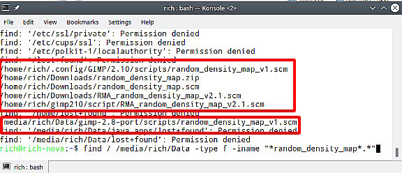

However: Linux is provided with a search function. In a terminal try
find / -type f -iname "*random_density_map*.*"
Which (hopefully) will find the file(s) in your home folder. You might need to expand the search, this for example is my home + a data partition.
best of luck.
