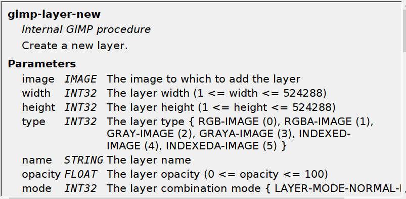

layer can't have as creation parameter RGB, but RGB_IMAGE
look
