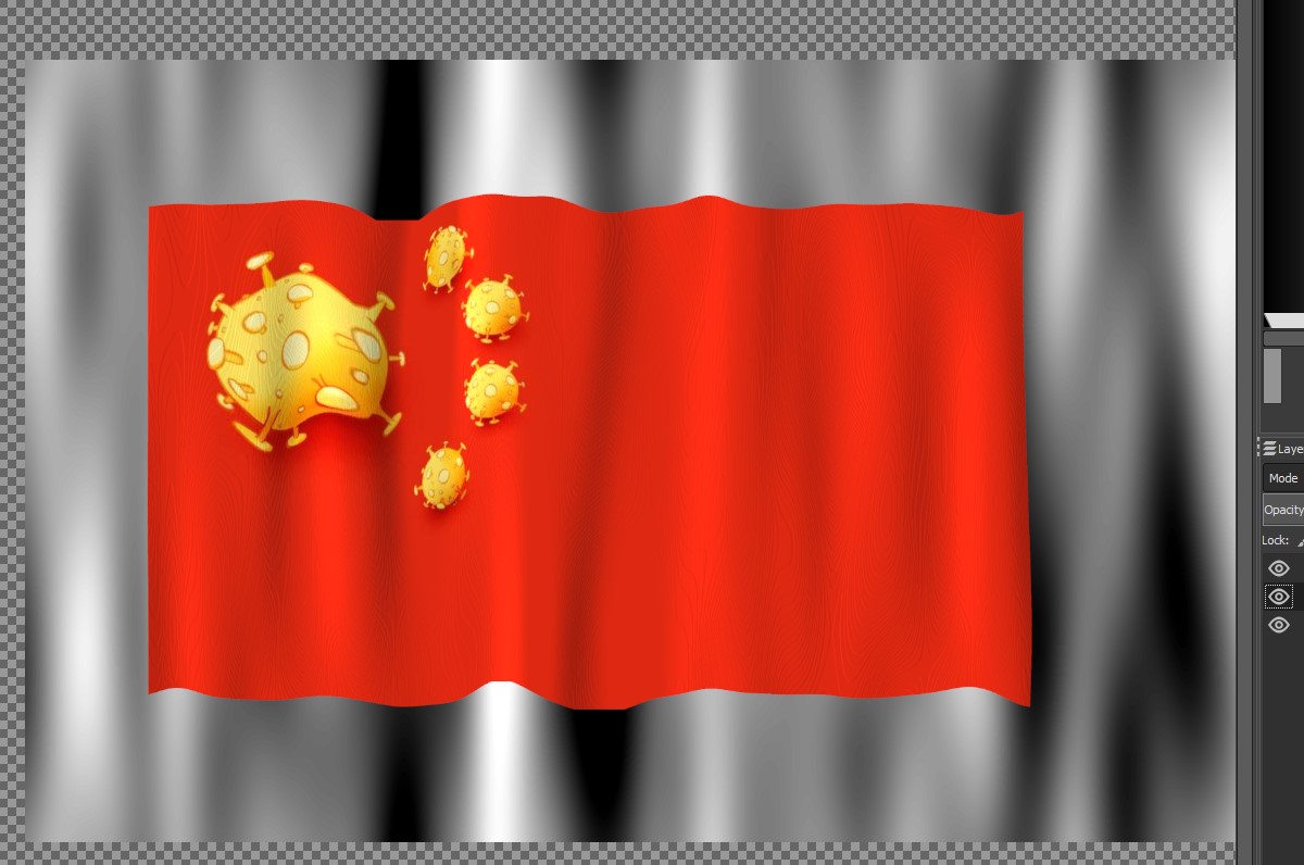

Hello! I need your help!!!
I write little script for Gimp version 2.10.14, this script will an animation. It use some procedures so plug-in-displace, plug-in-bump-map but they don't work, i don't know why? I changed their signature, changed value in every param but without good result. :( I want to get a result how i show in my attach file on picture
It code:

I guess it's due to a bug in GIMP 2.10.14.
Should be ok in 2.10.18

I just made a flag in MathMap - 10 frames and default settings for 'Flag' filter. I think it's ported to G'MIC by Zonderr.
I think the ends should 'flap' more.
