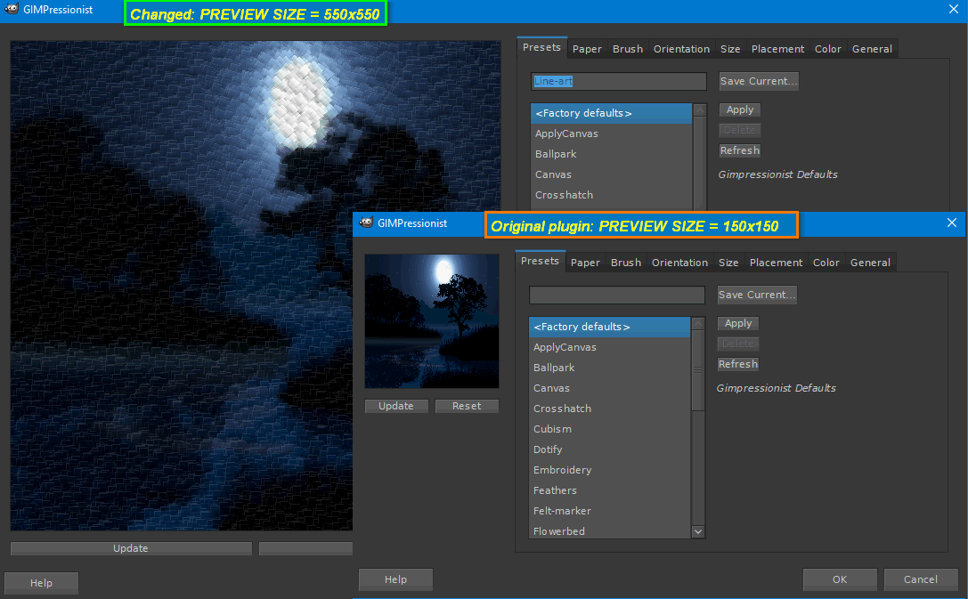

My solution:
In file gimpressionist.h (line 33)
replace:
#define PREVIEWSIZE     150
to:
#define PREVIEWSIZE     550
Very easy once you know the way... :hehe

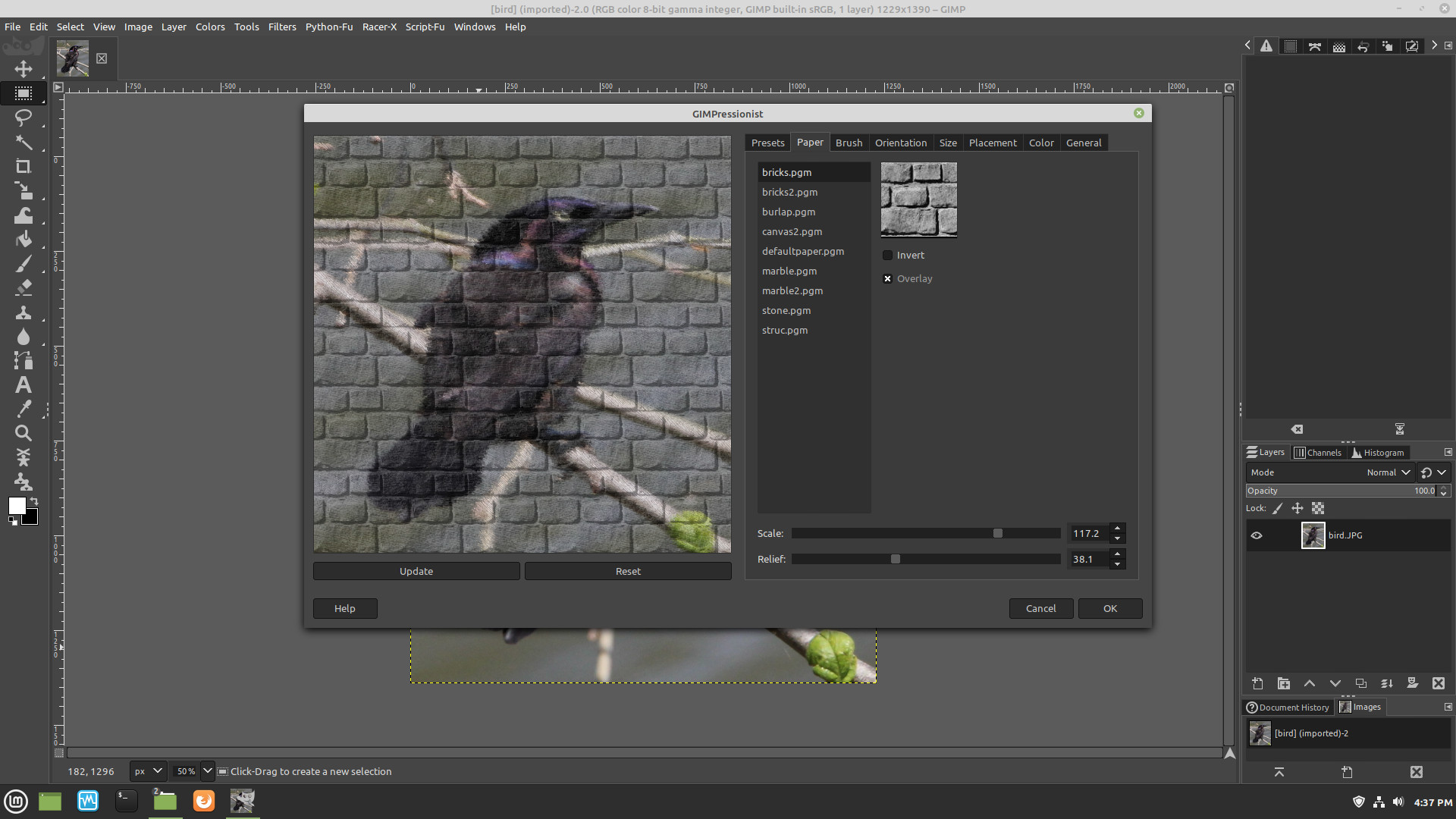

PostPosted: Sun Jul 12, 2020 3:42 pm  (#8)
OK, can confirm it works in LM-20 Cinnamon (based on Ubunto 20.04) running AppImage. It will not run in MX-Linux 19.2 (based on Debian Buster 10), even while running AppImage.

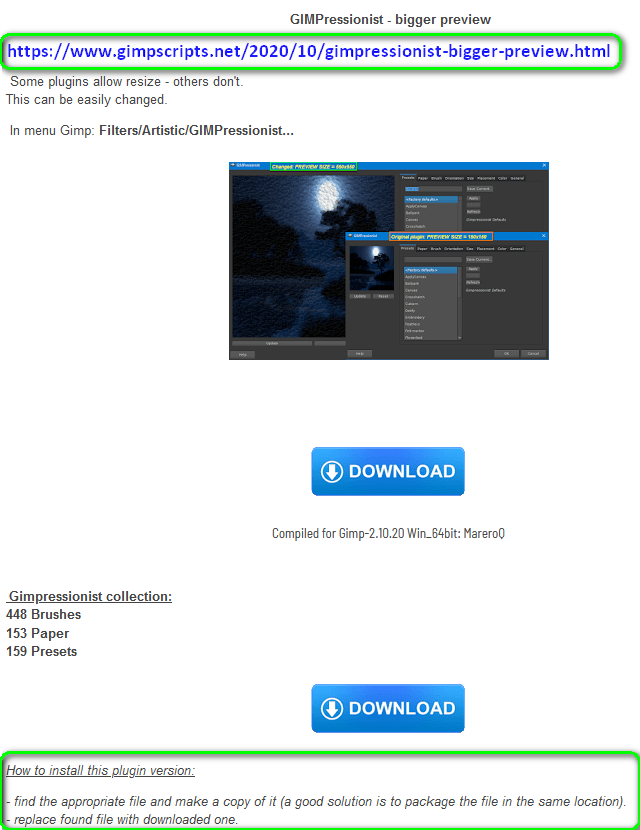

How is this version installed? There should be a how to on gimpscripts.net

@Mackenzieh
I don't understand Your post.
Is this not sufficient instruction for You?
