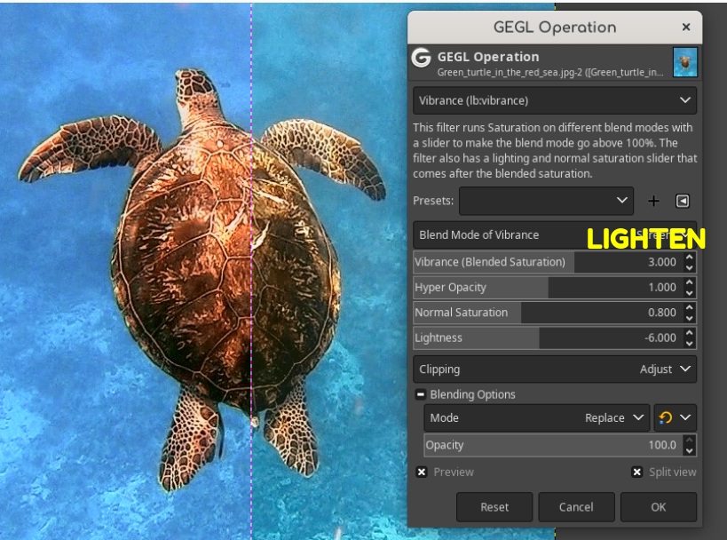

About the plugin
Adobe Photoshop and GMIC have a filter named Vibrance that is basically Saturation on an alternative blend mode with a few other things. I decided to make my own Vibrance filter in GEGL to mimic them. I even added features; hyper opacity and blend mode switchers, which no other vibrance filter has to make sure I am original.
Vibrance being applied on the turtle. The blend mode is actually "LCH Lightness" and it was accidentally named screen in the drop down list of this beta build. So I had to fuzz it out.
Currently, my Vibrance filter allows the user to choose between four blend modes (lighten only, screen, overlay and addition) with a slider called hyper opacity which allows the blend mode to above 100% (up to 200%). And still giving the user the ability to adjust normal saturation and lightness after the 'vibrance' is applied. In the industry "Vibrance" is a term that describes saturation on an alternative blend mode. I am fully aware Gimp's default saturation filter can be blended to make a "vibrance" effect but it cannot do the hyper opacity, lightness and saturation/desaturation on it. Though it does have the advantage of using all Gimp's blend modes and not just a few of them. I may add more blend modes before it is released.
Video preview of Vibrance
https://streamable.com/1mwmgr

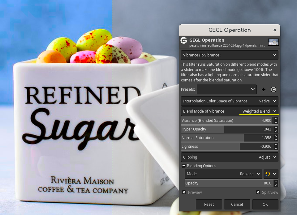

https://gegl.org/operations/gegl-weighted-blend.html
This is a GEGL exclusive blend mode called Weighted Blend that is NOT natively inside Gimp. I have never used this blend mode before, but it looks amazing. So good that I might make it the default.
Look how it is listed inside the code
it was given the name wb in the new child operation list and WB in the ENUM drop down list area. So look for that.

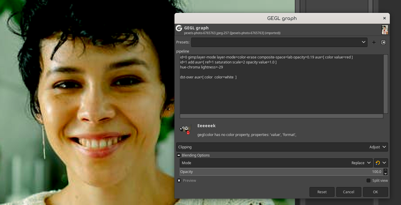

I just wrote a bunch of GEGL syntax that dulls the color red from saturation but preserves everything else. It is sloppy because it depends on the original image file and not id and ref.

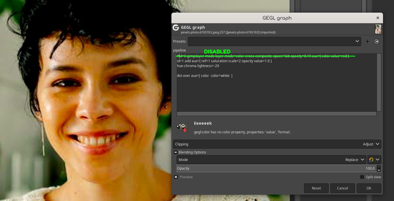

I found a simple way to keep green and blue saturation but decrease red saturation using only a few lines of GEGL syntax.
The saturation is kept on green in the image but the red is reduced.

If I disable this line the red comes back

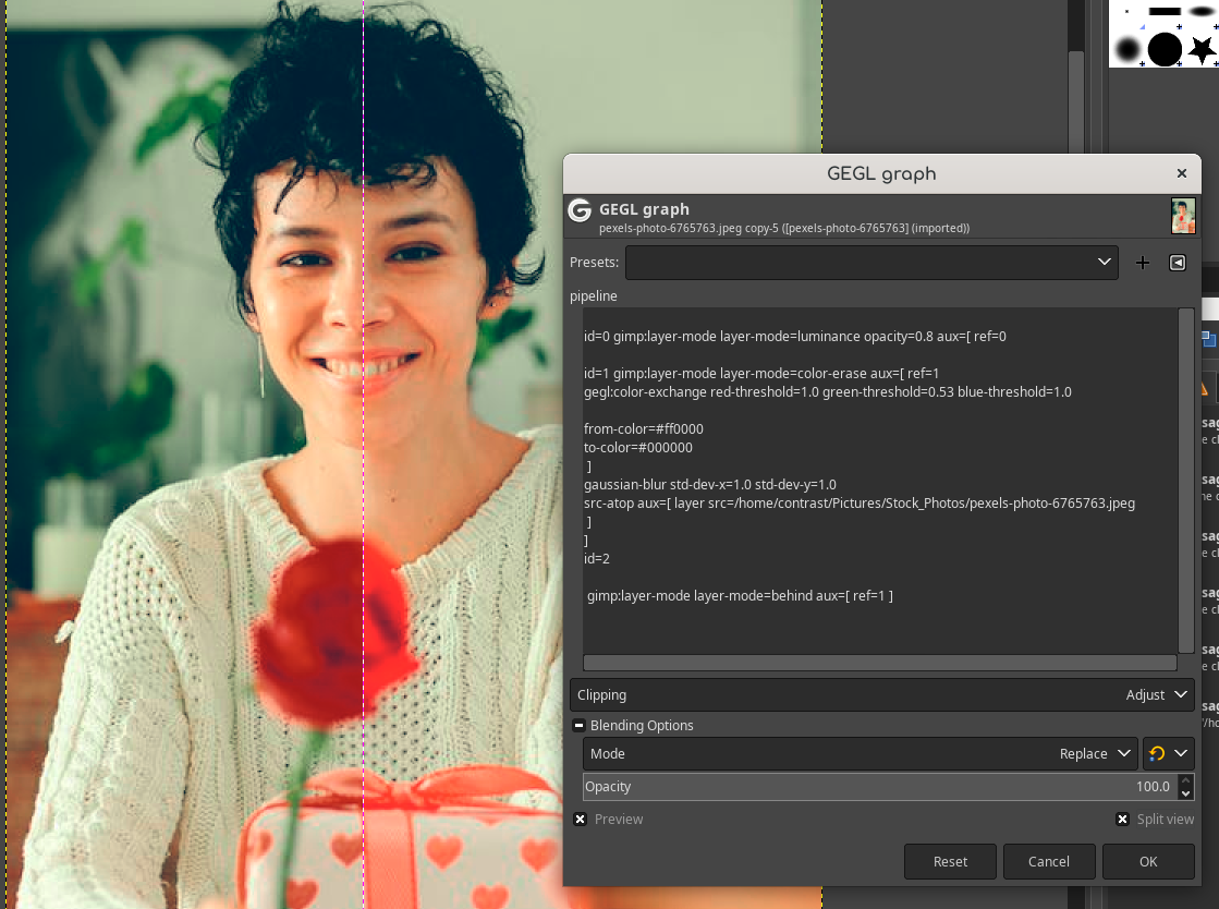

I made a graph (aka GEGL syntax) that depends on my plugin Edge Smooth (which can be downloaded here as a dependency of chrome text)
https://github.com/LinuxBeaver/GEGL---C ... r/releases
This GEGL syntax saturates green and blue and ignores red almost entirely. I don't know why I should make it a filter when it can be entirely controlled in GEGL graph using the master opacity slider that all GEGL filters have. At 0% to 100% opacity the effect is controlled.
Paste this syntax into GEGL graph to "vibrance" an image and make sure to tweak the opacity slider of GEGL graph.
