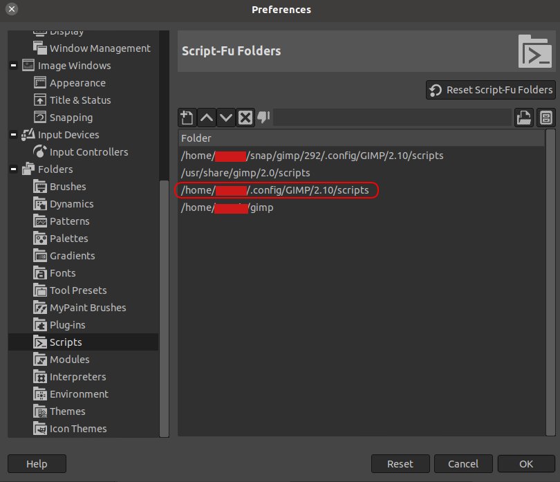

1) These are my script-fu folders:

Assuming Gimp was intalled via PPA, then this is where you need to put your scripts.

I installed GIMP via Ubuntu Software. So, I moved my script to ~/.config/GIMP/2.10/scripts, but I still get the same error:
