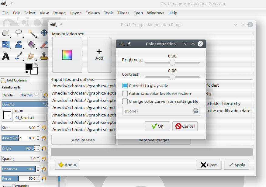

The easiest way for a large number of images is use an existing plug-in BIMP see: https://alessandrofrancesconi.it/projects/bimp/ where you can add various procedures including a convert to grayscale.
Edit: This issue came up one time. Using BIMP and png format an alpha channel is added. No way to avoid this with BIMP as the export is the final function.
If the alpha channel is a problem (larger file size etc) then this is a batch plugin for removing the alpha channel following on from BIMP.
https://github.com/samvanemelen/GIMP-pl ... ansparency

rich2005 wrote:
The easiest way for a large number of images is use an existing plug-in BIMP see: (snip, snip) where you can add various procedures including a convert to grayscale.
....(snip, snip)
(snip, snip)
Edit again ;)maybe the gimp procedure if you want to write your own batch file is
pdb.gimp_image_convert_grayscale(image)
..but as you say not bitdepth. As an example attached a simple python script that does that for an open image.
Great stuff, that's saved me a lot of time poking around trying to find something that didn't exist ;) I might come back to the python option, so thanks for the example script - very useful. Cheers :)
