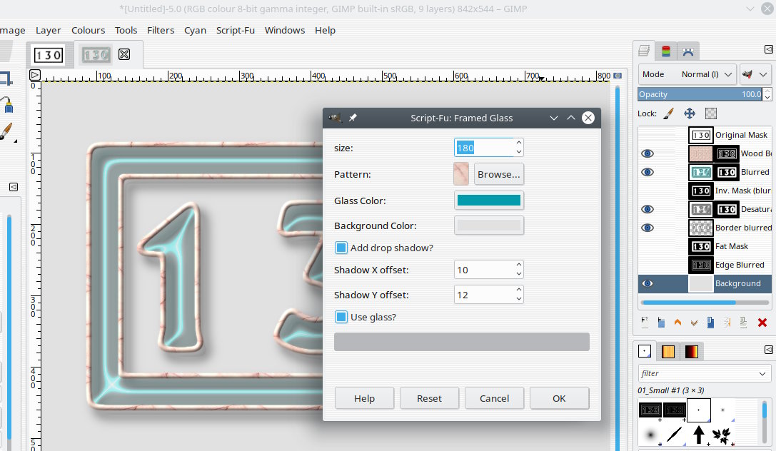

It only seems to work with size 100. Other sizes give an error.
 Post subject: Re: Framed glass text
PostPosted: Thu Mar 25, 2021 3:06 pm  (#5)
Sorry, I was wrong. Some numbers work and others don't for some reason. This was at 130.
PostPosted: Thu Mar 25, 2021 3:12 pm  (#6)
It's working for me at any size. Are you only changing the size and nothing else?
PostPosted: Thu Mar 25, 2021 3:13 pm  (#7)
No, I changed colours and pattern but that is all. I tried size 40, 60, and 150 and none of them worked.
PostPosted: Thu Mar 25, 2021 3:17 pm  (#8)
How peculiar - it's suddenly started working!!!
PostPosted: Thu Mar 25, 2021 3:21 pm  (#9)
Yep - it's working consistently now. Thank you.
PostPosted: Thu Mar 25, 2021 3:46 pm  (#10)
And I spoke too soon. It won’t allow over 512 px width.

This is one problem, line 383 which uses plug-in-edge. Putting in a large value for size into the script can give an error but it also depends on canvas size.
The plugin changed from
Gimp 2.8: amount FLOAT Edge detection amount
to
Gimp 2.10: amount FLOAT Edge detection amount (1 <= amount <= 10)
Probably not going to bother most users. however a quick remedy is fix the value of amount in the script.
