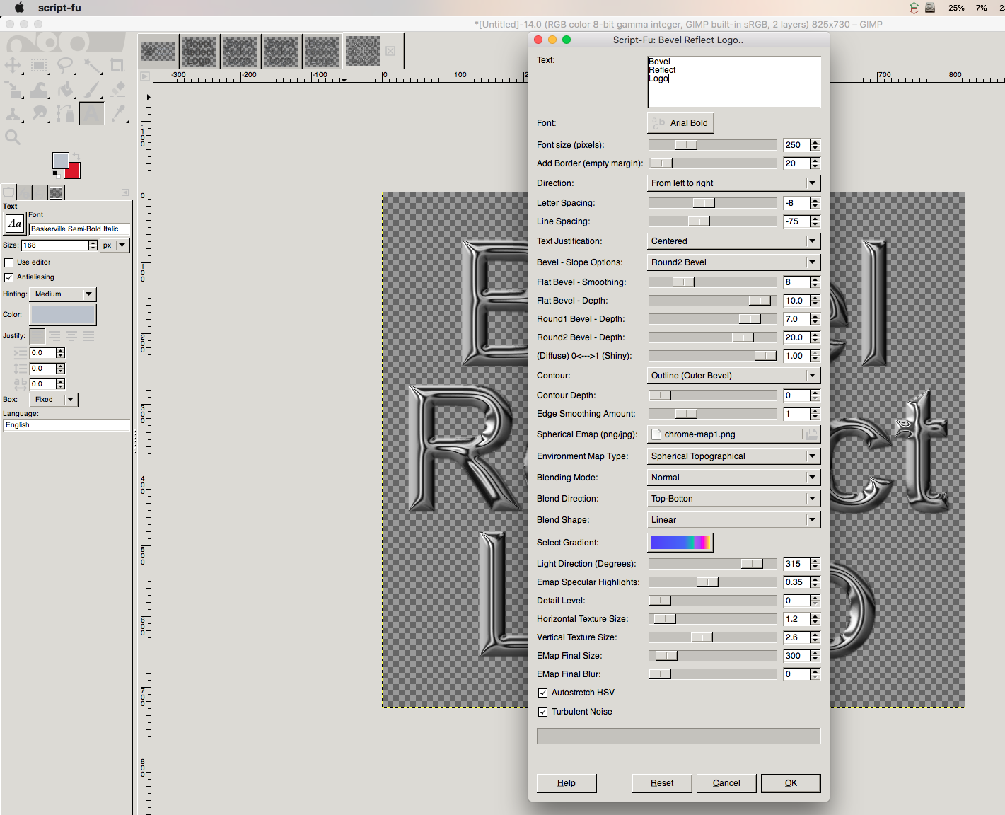

Anyone have an idea about this error I'm running into? Notice the missing scroll button, cancel, and OK. All of the files are in place (but the script may not like the location). I'm not certain if its not finding the loader, or if its not finding the icon. Maybe I'm missing a dependency? Any thoughts?
(mlbevelreflect2:78734): LibGimp-CRITICAL **: 17:02:07.246: gimp_drawable_preview_set_drawable_id: assertion 'priv->drawable_ID < 1' failed
(mlbevelreflect2:78734): Gtk-WARNING **: 17:02:07.895: Error loading theme icon 'gtk-cancel' for stock: Unable to load image-loading module: gdk-pixbuf-2.0/2.10.0/loaders/libpixbufloader-svg.so: dlopen(gdk-pixbuf-2.0/2.10.0/loaders/libpixbufloader-svg.so, 1): image not found
(mlbevelreflect2:78734): Gtk-WARNING **: 17:02:07.896: Error loading theme icon 'gtk-ok' for stock: Unable to load image-loading module: gdk-pixbuf-2.0/2.10.0/loaders/libpixbufloader-svg.so: dlopen(gdk-pixbuf-2.0/2.10.0/loaders/libpixbufloader-svg.so, 1): image not found
(mlbevelreflect2:78734): Gtk-WARNING **: 17:02:08.009: dlopen(gtk-2.0/2.10.0/immodules/im-quartz.so, 1): image not found
(mlbevelreflect2:78734): Gtk-WARNING **: 17:02:08.009: Loading IM context type 'quartz' failed
(mlbevelreflect2:78734): Gtk-WARNING **: 17:02:08.011: dlopen(gtk-2.0/2.10.0/immodules/im-quartz.so, 1): image not found
(mlbevelreflect2:78734): Gtk-WARNING **: 17:02:08.011: Loading IM context type 'quartz' failed

Here are some screenshots:

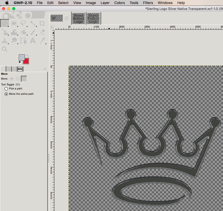

Here is another:

Well, I was able to fix the missing button icons by making a gtkrc for gimp and turning the icons off.
The plugin and script seem to work quite well in macos and seems to do what they are suppose to do.
The preview scroll button issue is cosmetic and I'll have to live with it for now, as it looks like that code
will probably have to be updated before it is really correct. Lots of things have been deprecated since it was
written and it's probably time for an update for it on the macos side.
So, if you want to use it on your mac, you now know that it will work, but it will require some effort for the time being.
