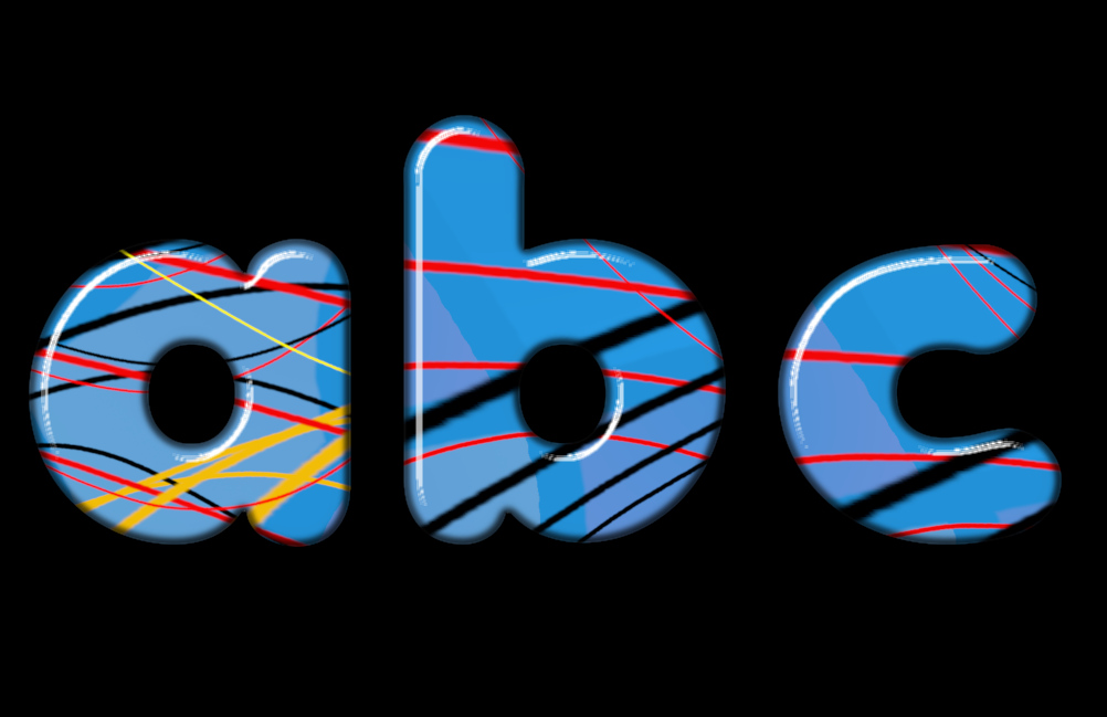

And examples of the style of font face created from the images...
