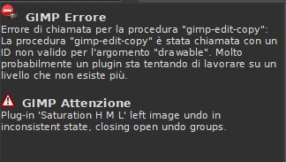

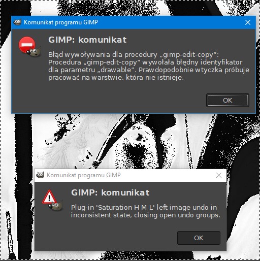

Hi David.
A strange story.
It works in the English and French versions of Gimp.
It does not work in Italian and Polish. :gaah

Possibly due to "saturation_layer = pdb.gimp_image_get_layer_by_name(decomposed_image, 'saturation')" that will only work in some languages.
@david what is likely the same everywhere is the stack order, so instead of using names you can use "image.layers[position]" once you have figured out which of H, S, V correspond to 0, 1, 2.

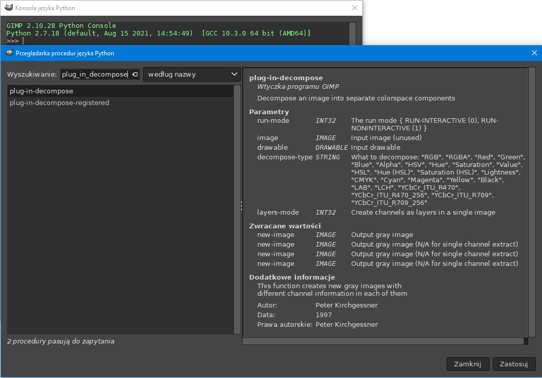

Out of curiosity, if you look at decompose in the procedure browser, in either the Polish or Italian versions of GIMP, does it show the English version - HSV - or is it translated?
 Post subject: Re: Saturation H M L plug-in
PostPosted: Fri Oct 29, 2021 12:32 pm  (#12)
Python Procedure Browser is translated to a very limited extent.
