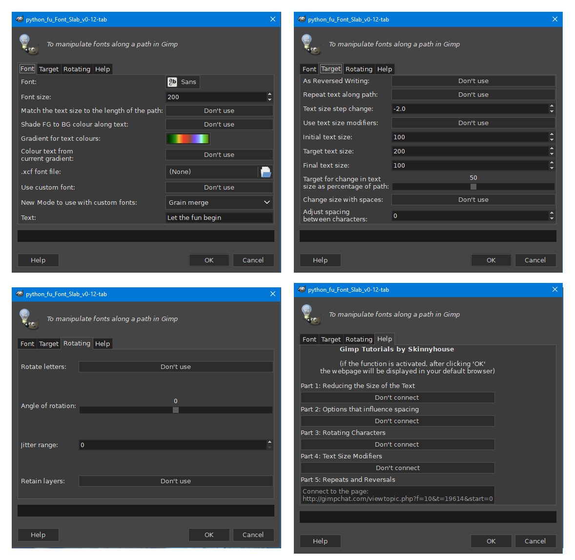

Hi Skinnyhouse.
I don't know if I can experiment with such a good plugin.
Will You accept the tabs (according to gimpfu3 by J.F. Garcia [arakne] ) and the new "Help" type for Your plugin?
If YES - tell me what would be the best division of tabs (names and attached commands)?.

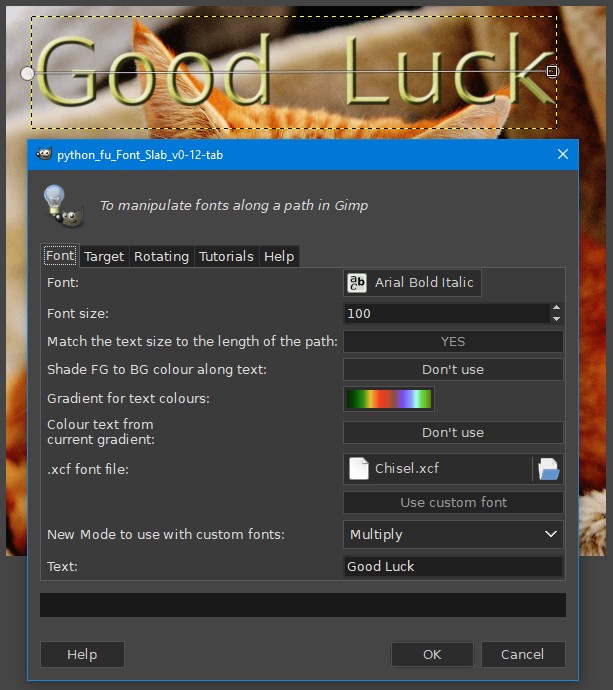

I think You should have full personal control - so play with my attachment (to be removed when You publish an authorized version).
Attachment removed 29/09/2021.
Skinnyhouse works very fast. :yes
The operation was successful.
Authorized version for download here.

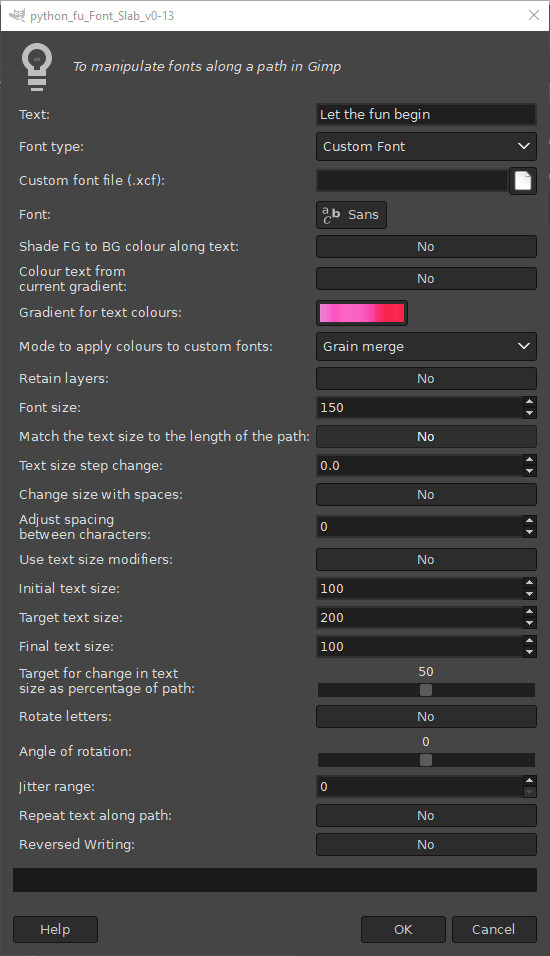

Here is the look of the untabbed version that would use the new dialog arrangement and slight modifications...
This would equate to 3 tabs for the filter options plus 1 tab for the tutorials
Tab 1: Fonts & Colours
Tab 2: Size and Spacing
Tab 3: Rotation, Repeats & Reversals
Tab 4: Help Guide

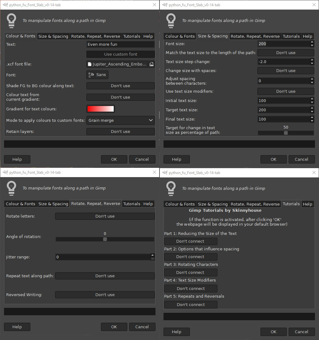

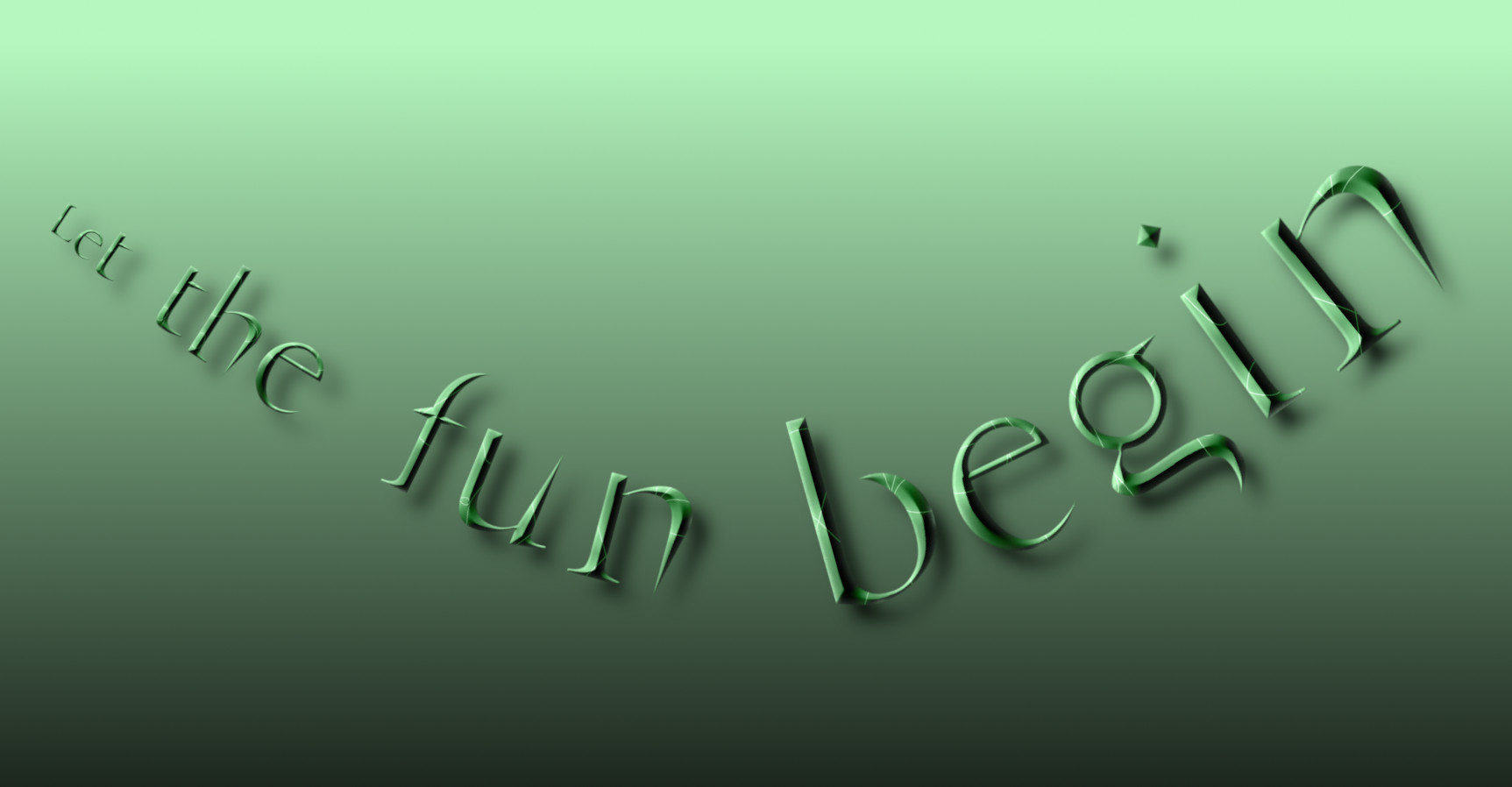

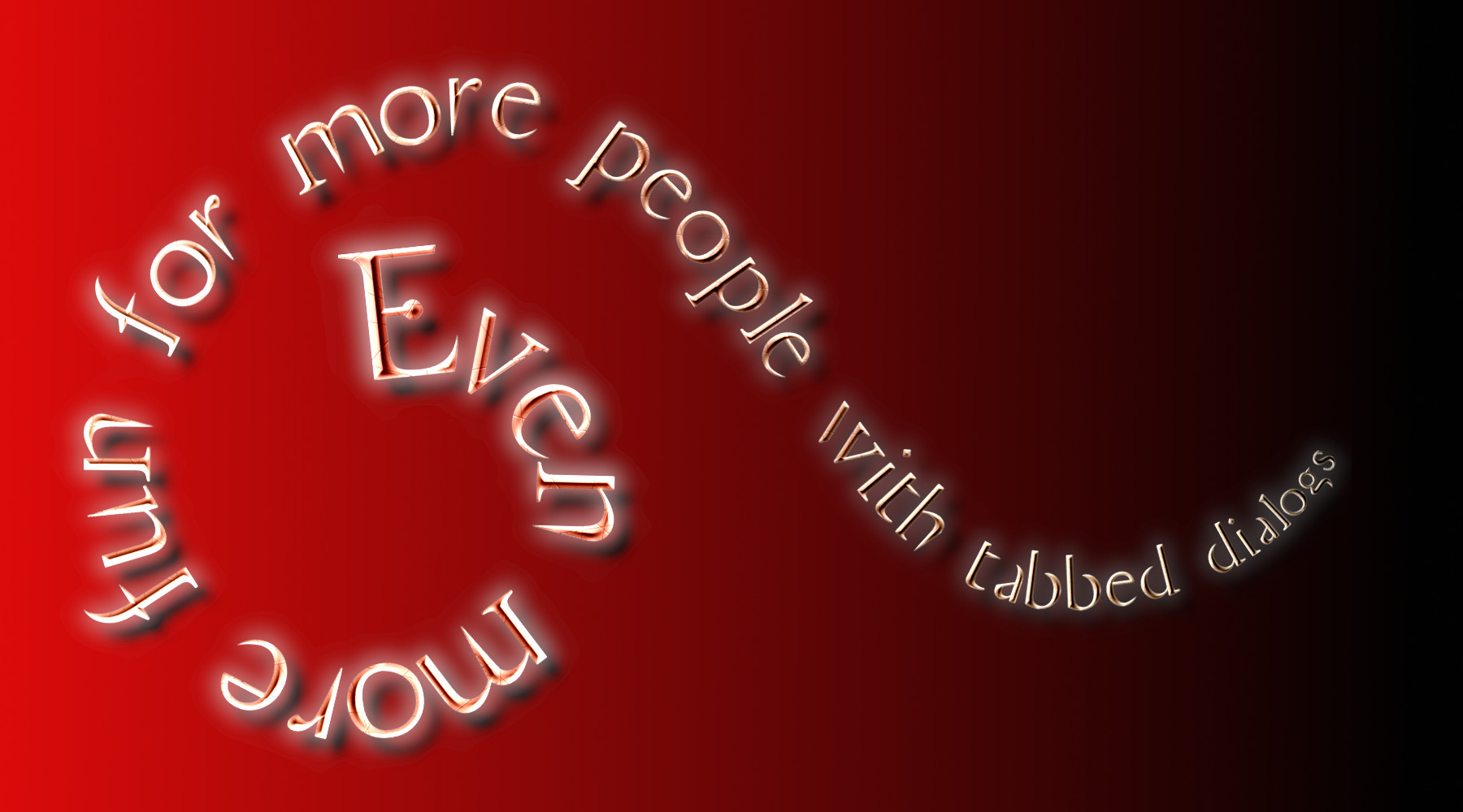

New dialog tabs...
