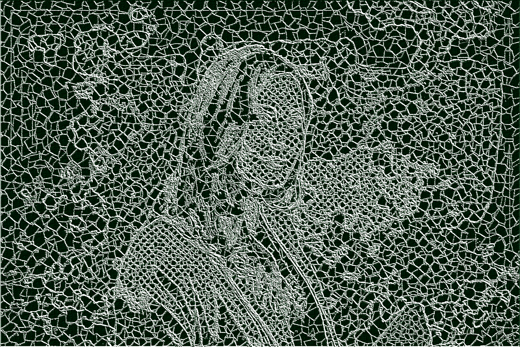

I remember CrazyCrochet, was there a plugin for this? If it still works in 2.10, where can I find it? Thank you!
 Post subject: Re: CrazyCrochet
PostPosted: Fri Oct 01, 2021 12:38 pm  (#2)
Posts: 14831
Is this what you are looking for?
It's called Crochet Look

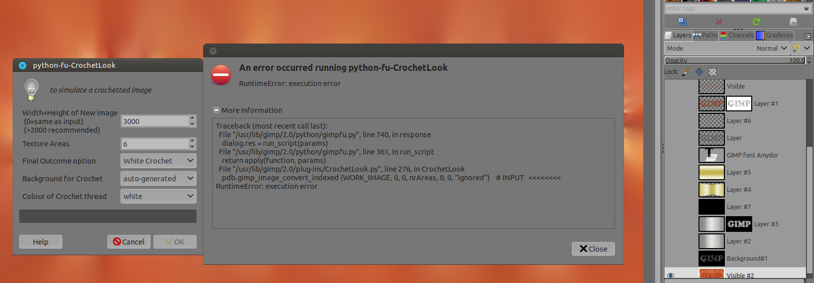

Did you try CrochetLook? Any comment? Any outcome?

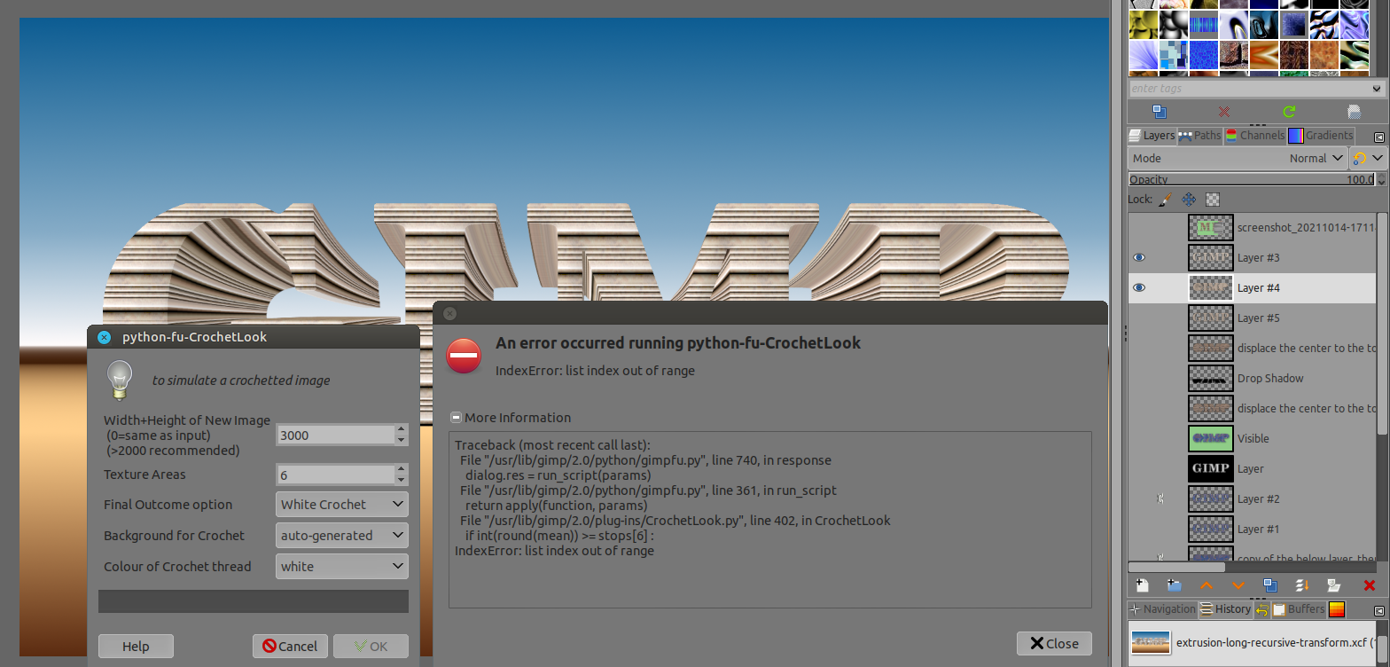

I did try... and found at least 2 bugs (or I don't know how to use it)
When a layer already is in a stack (top, bottom or middle) even with the default setting, it does not work at all.

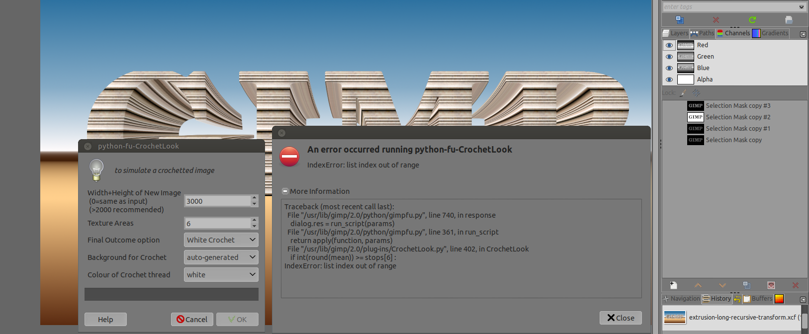

Alone as new image, when I put "texture areas" below 6, it does not work (out of range),
Also it would be nice to be able to go down to 1 to get a "large free" area.
Other than that, when it works, it's a very cool script and I can see many uses even outside of the "crochet look", nice script thanks a lot Diego ;)

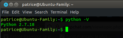

Yes, I have python2 installed as well :bigthup

@PixLab
Looking at your found errors:
1.if the source image is multi-layer the filter does not work
Did you have a selection all active?
I ask because I tried to reproduce the error preparing a test image with:
- a BG with a texture
- a second layer with the image I like to "chochet"
- a 3rd layer with a different texture
I set active the second layer.
The filter works (*) if there is no "selection all" active. Abends if there is.
Could you please test?
edit: works in the sense that it does not abend, but the filter does not preserve properly the existing layers

2.About the number of areas
The filter has been created to render a crochet representing an image, and it makes use of different crochet sizes to offer a better rendering.
Yes, 6 is the minimum. I didn't identify that limit clearly to the user.
I will replace the filter setting 6 as minimum value.
PostPosted: Sat Oct 16, 2021 3:32 am  (#12)
Posts: 14831
Updated filter, two small changes:
1- the minimum number of areas has been set to 6
2- if there is a selection all active the filter should not abend any more
DIEGO_CROCHETKNITPATCH_CrochetLook.7z [7.01 KiB]
Downloaded 73 times
errors detected by PixLab, thanks

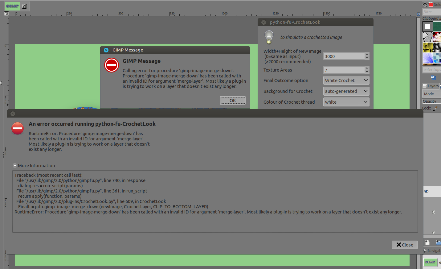

nope no selection at all while I was testing (I did care about it from the first time),
BUT I do "always" have some channels...,
see my channels below with an another .xcf I tested and default values of the 1st plugin

Second plugin (the "fixed" one) still the same = I got an error when I have layers (nope, nothing is selected and never was ;) ), but saved selections in channels yes ( they are un-activated ;) ) just started the plugin directly click OK (default values (image with some transparency areas or WITHOUT..)
but it works on a single image (no added channels -> brand new image) like the first plugin.

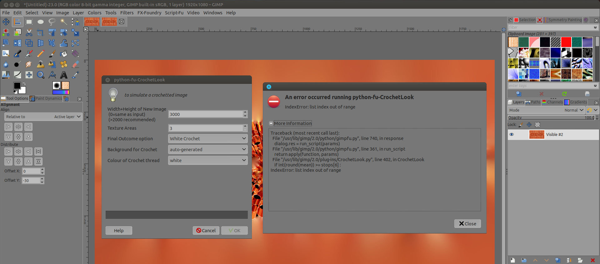

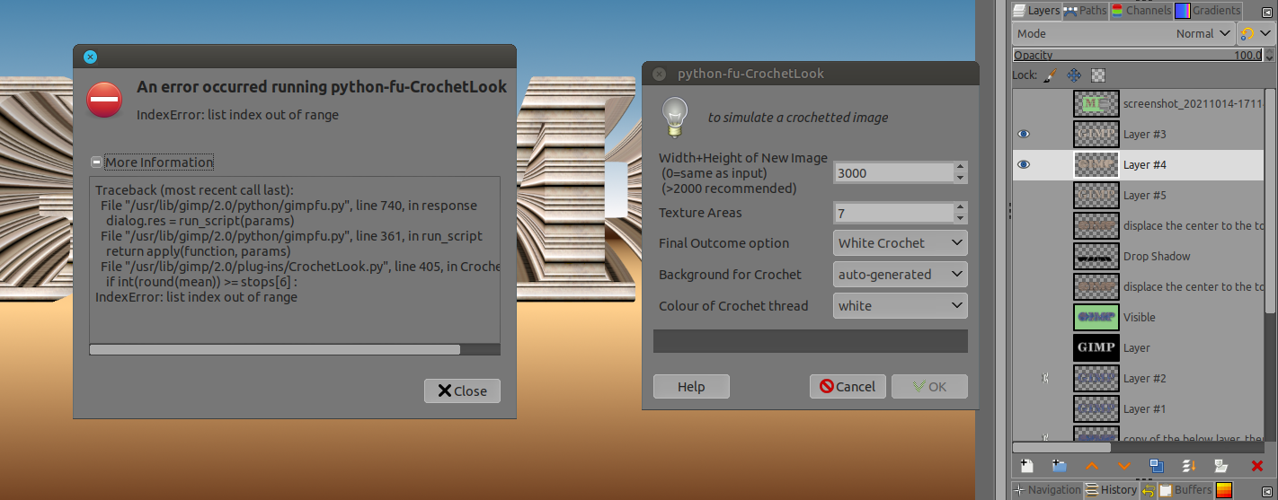

This time it worked longer, but crashed near the end after "Emboss"
(on a single image it is working :bigthup )
Patrice

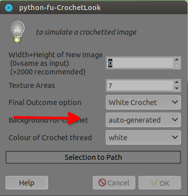

It seems to be the "auto-generated" background
because it worked when I chose transparent Bg, but if it's auto-generated -> it crashes

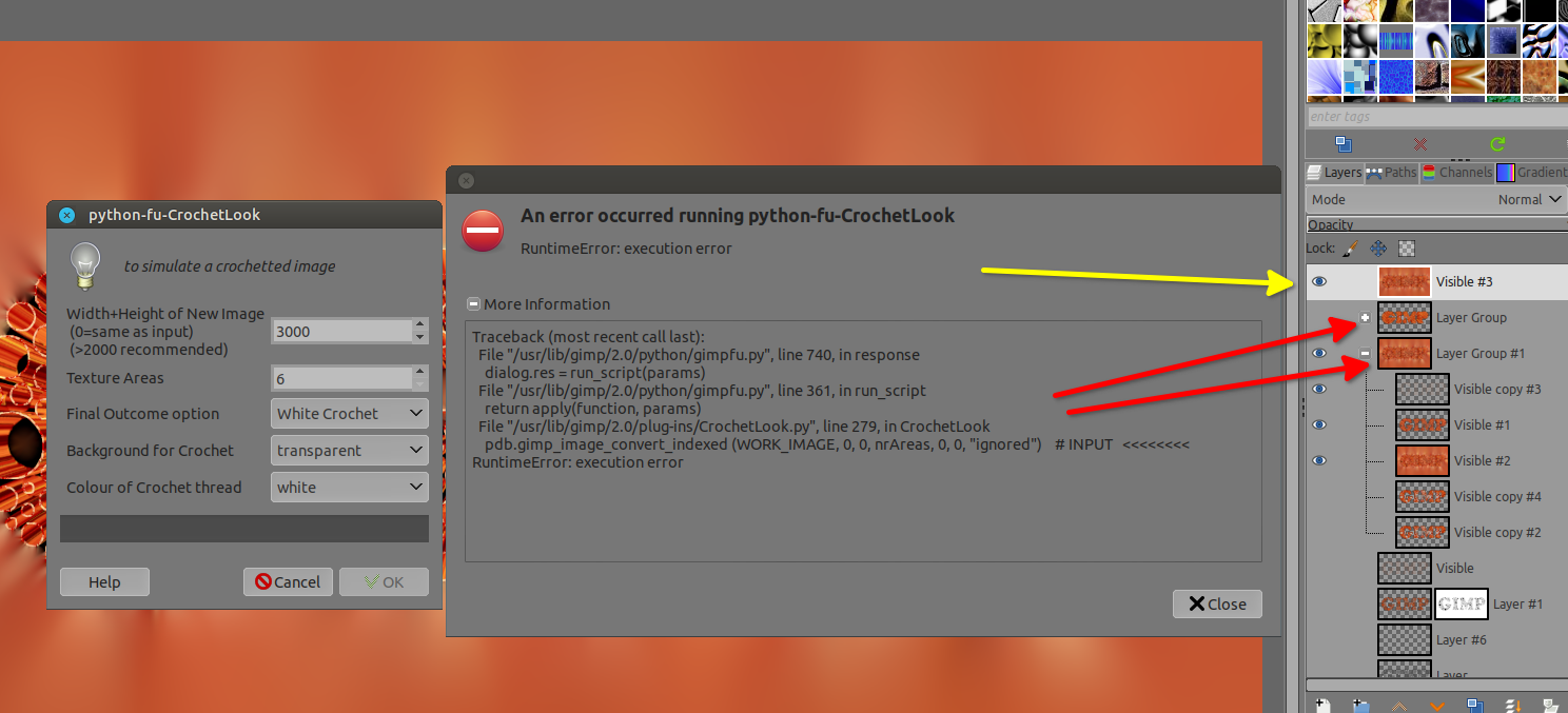

Also I discovered if there is even 1 layer group only in the layer stack, it does not work, it just crashes systematically whatever setting we input ;)
Hope this help
Patrice

Yes, I agree with you with multilayer images we have to choose transparent BG.
PostPosted: Sat Oct 16, 2021 11:43 am  (#18)
Posts: 14831
Maybe I can just add a note on the panel with the parameters, if you think it can help users.
PostPosted: Sat Oct 16, 2021 11:44 am  (#19)
Posts: 14831
Level Group is not supported, in fact.
PostPosted: Sat Oct 16, 2021 11:48 am  (#20)
Joined: May 24, 2021
Posts: 859
I think it would be nice :bigthup
Patrice
